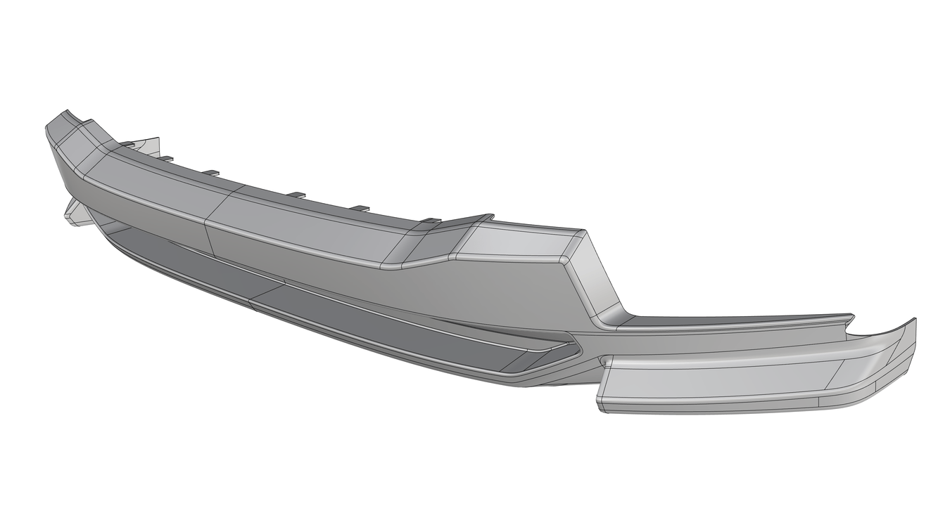

Recently, it took me roughly 4,5 hours to make a 3 mm offset surface for 3d printing of this front bumper, despite the good continuity between surfaces and angle tolerance of 0,1 degrees. The problem mostly comes from offsetting a polysurface consisting multiple joined surfaces. The offset joined surfaces get re-trimmed and shrinked, so this results into extremely tiny gaps here and there (like 0,0010854 mm, for example). This forces me to untrim the offset surface, extend its border, then trim it again with manually built trimming curves (mostly extracted edges of the nearby surfaces or blend curves). If the offset surfaces were NOT shrinked and behaved in the same way as offsetting a single surface (preserving the size of the original, no matter whether it’s trimmed or not), that would help with having less errors like that.
There were also a few self-intersections on the offset surface, so I had to untrim and trim again those areas and build blend surfaces there.
4,5 hours is super slow for such a basic task. I know that “Offset” is not exactly “Shell”, they are different commands, but they are supposed to work in the same principle, i.e. offsetting the surfaces to build thickness.

That looks like it would be a great piece for the developers to use in their refinement process. It looks generic enough that if you don’t say who your customer is it shouldn’t be an IP problem to send it to McNeel. Or maybe you could take the original underlying surface and modify or distort it so it doesn’t match your customer’s (employer’s?) part but still demonstrates all the offsetting issues?
It’s a model for a customer, so I can’t share it. However, I may create some smaller example with similar surface transitions if “McNeel” needs it to test their improvements of the “Shell” and “Offset” commands. But the main problem, as I mentioned in my post above, is that Rhino shrinks the offset surfaces, so this creates a real possibility for the latter to have some tiny gaps between the joined edges.

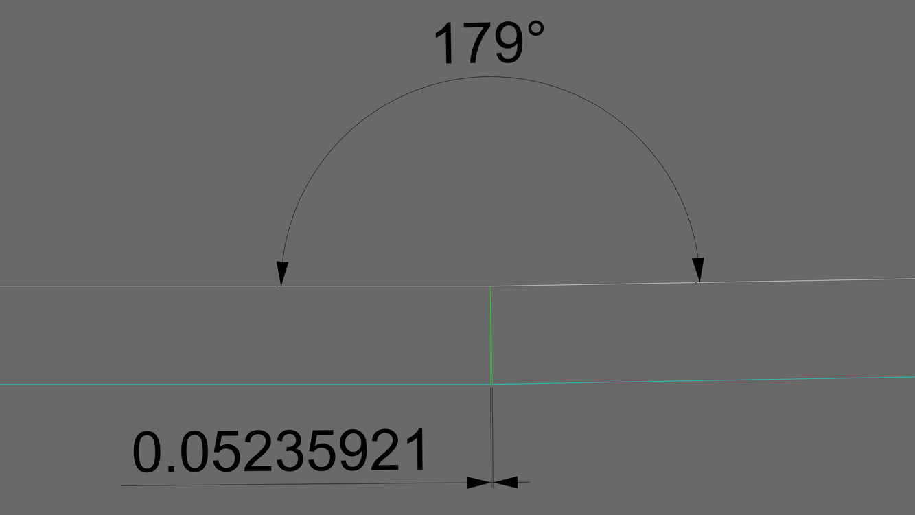

It also comes from the fact that angle tolerance is very important for offsetting. For example, if the input geometry has 1 degree deviation of the tangent continuity between two surfaces, an eventual offset of 3 mm may result into two separated surfaces, because 1 degree crease, when projected to normal at this distance, makes about 0,0523592 mm gap OR 0,0523592 mm self-intersection (depending on whether the 1 degree difference in tangency between the input surfaces is towards the outside or inside of the thickness). With an absolute tolerance of 0,001 mm that would immediately translate into a gap that needs extra manual work to be fixed.
However, an angle tolerance of 0,1 degree (I use this to minimize the unwanted gaps when adding thickness to parts) has a better chance to make the offsetting as expected, because 0,1 angle and 3 mm offset in the normal direction results into a 0,0052360 mm gap. I use 0,001 mm absolute tolerance, so even such small gaps could be problem sometimes. For parts that need thickness I put some extra time to make sure that the tangency between their surface edges are as close as possible to 0 degrees, because that’s vital for having a good offset wall.
