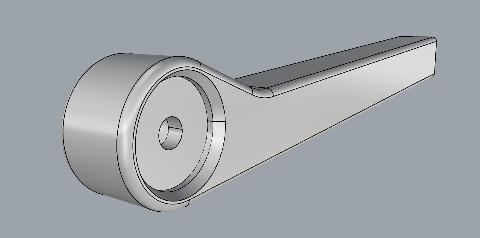

Wish: Rhino must use extended start and end planar cap surfaces when extruding curve profiles consisting quad/tangent edges. The following video reveals the complications that occur around quad regions after extruding circular profiles. Note that the `! _Cap` tool is clever enough to avoid that shortcoming. The `! _ExtrudeCrv` also needs to implement the same approach. 🙂
[![](https://global.discourse-cdn.com/mcneel/uploads/default/original/4X/4/8/e/48e13928f7c65f9025f755866be883a62ef818e5.jpeg "Rhino should extend the border of the planar extruded surfaces to avoid splitting the tangent edges") ](https://www.youtube.com/watch?v=e8NqNhSHWek)
This model was created with perfectly accurate lines and circles with exact diameters each. I used 0,001 mm absolute tolerance. However, for some reason running the `! _What` command reveals that the model has some unwanted deviation and gaps larger than the absolute tolerance (despite that the “Global edge continuity” claims 0 mm for every edge pair). The bug was caused after adding a single 10 mm fillet with the `! _FilletEdge` command.

> [@Rhino\_Bulgaria](#):
The 12 mm bore is not a true cylinder. If you make a 12 mm dia circle and extrude, you can then extract and replace the bad surface with a true cylinder that fits perfectly.
[fillet the edgesx.3dm](https://discourse.mcneel.com/uploads/short-url/xn7j8orW6OE1aimCJymOdzH3vaq.3dm) (2.4 MB)

The edge selection problem appears to be caused by the trimmed edges of the sides being tangent with the edges of the underlying untrimmed surface.
Extract the sides.
Untrim the sides.
Note where the edges of the center portion are tangent with the edges of the untrimmed surfaces.
 ![image](https://global.discourse-cdn.com/mcneel/uploads/default/original/4X/8/d/7/8d7106d7f097f8eda421510e4888d9a192b26c17.jpeg)
Extend the sides.
 ![image](https://global.discourse-cdn.com/mcneel/uploads/default/original/4X/8/0/1/801cdf2a14359bf3860432eb80fb1786ed97fe30.png)
Trim the sides using the center portion.
 ![image](https://global.discourse-cdn.com/mcneel/uploads/default/original/4X/c/c/2/cc21e13a42817079e97fa030c958f802b7be4789.jpeg)
FilletEdge the edges. 1mm radius.
 ![image](https://global.discourse-cdn.com/mcneel/uploads/default/original/4X/8/c/3/8c384b812b513b2c02bfe63a3443590a9e0aeddf.jpeg)
[Can’t fillet the edges DC01.3dm](https://discourse.mcneel.com/uploads/short-url/9PBAMaso2oEcIBe9jIL8kqIkP37.3dm) (2.2 MB)

Just for fun I remodelled the object again four times using different techniques. All have clean surfaces and tight tolerances, and edges filleted happily. No surfaces needed replacing or enlarging.
 ![image](https://global.discourse-cdn.com/mcneel/uploads/default/original/4X/3/d/b/3db3a804c3c5213fb35c3c2918f2dd7b920b276b.jpeg)
The purple object was modelled “without using the ‘Solid’ menu” (apart from \_FilletEdge at the end, as with all the objects).
The brown object was modelled using solid modelling with extruded ‘cutters’ boolean differenced from a solid body to create the holes.
The grey object was also modelled using solid modelling, but with polysurfaces rather than extrusions.
The green object was a late addition modelled primarily using surface modelling but taking advantage of new information from Bobi to more closely mirror his actions. The 10mm radius in the top was applied as a fillet instead of using a curved profile; the chamfer was applied as an equal chamfer and the inner edge was sub-object selected and moved inward by 0.5mm as he had done.
The only differences resulting from the various techniques were:
1. Either one or two edges between the chamfer and the cylinder, depending on whether their seams aligned or not (to be expected).
2. Different uv directions on equivalent surfaces.
