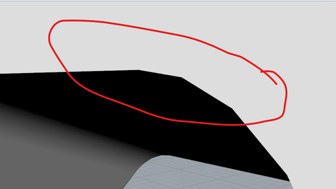

Wireframe mode has smooth edges, but shaded/rendered mode shows sharp edges
unhandled
#1
as you can see the edges are very sharp
But wireframe mode show smooth curves
rhino model edge.3dm (39.0 KB)
I am complete beginner to rhino. Any help would be very appreciated.
Thanks
(Jakob Normand) #2
Hi @Abhijeet_Tambe
Take a look at this: https://wiki.mcneel.com/rhino/meshfaq
HTH, Jakob
#3
Thank you so much !
