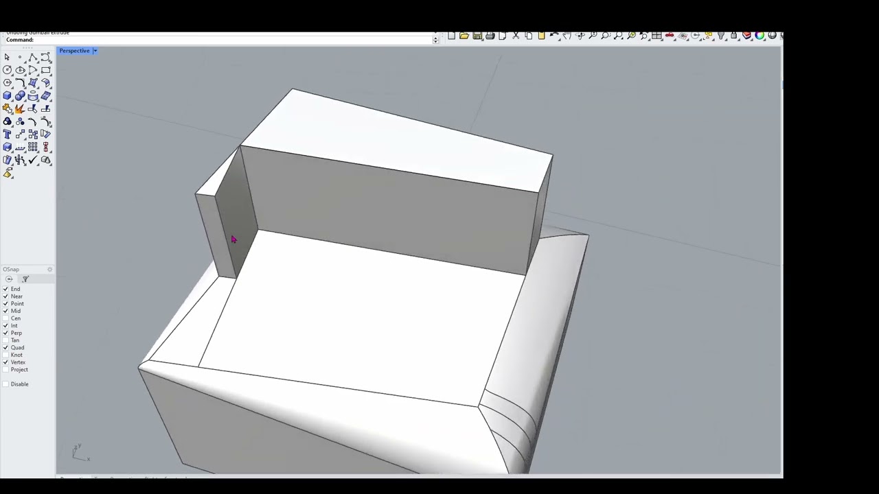

currently the wirecut command create issues that i described in the video
here i proposed a solution as subcommand “ScaleWire” under wirecut which can be also be called as “ExtendWire”. this will atleast solve the issue with straight-line cut and can be fully implemented when the user select subcommand “line” after wirecut but for curve wire it can create issue.

I’m hearing the problem is “wirecut fails to cut all the way thru a part when the cutting line lies on the object, but does not extend thru the object”
please rewrite, correct or add anything to the above-
that fair?
Exactly what I was thinking.
I just want to cut them as seperate object so it dont create issue in later operations as you see here-

v8 has a new gumball modifier called cut you can alt + drag an edge to copy the edge, then drag the cut handle to make the cut you are showing
and you can also double click the gumball rotate handles to align it to your curve, then scale via the handle, and then cut via the cut handle.
Imo the double click transforms for gumball are super useful and may actually be the way to solve your modeling problem in this case.
you guyz saying right and i am aware of those tools as well But If you closely see the video you will see that it is also showing the cut line on the solid as i am scaling the wire that give me idea about location of the cut.
