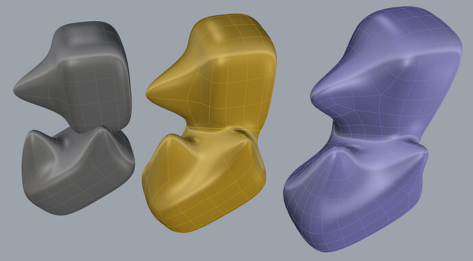

The tool definitely does still have plenty of bugs and strange behaviour for many cases, but this doesn’t seem like one to me - in what you show here it looks to me to be working just as it should. What other result you’d expect for this? - your input is on the left, result on the right.
Now as a human I can guess that maybe you’re after is to change this region:
into this:
…and manually I can remove those faces and fill in with a new strip of quads.
I don’t see how the algorithm could know that this is what you want though, since those extra faces around the lip do exist in the input, and in other cases might represent details you want to keep.
I do agree that it would be nice to have better tools to make this sort of process easier, though I would see it as clean-up after Fuse rather than part of Fuse itself.
I was actually looking at something recently in relation to this thread, that could maybe be relevant for this sort of hole filling with patches of quads:
(input in grey, filled result in orange)
As for showing more clearly the borders/new faces in different line weights/colours - good idea. I’ve been using something like this for my own internal testing and development of the tool, but can see how revealing more of the workings would probably make it easier for users to understand and control too. (btw - re faceted mode, in Grasshopper just connecting a ‘Mesh’ parameter component to a SubD output gives you the control polygon). For the Rhino command there’s still other stuff to figure out about how best to show both input and result in a clear way, but agreed that faceted mode should be an option.

The approach and result there is quite different from what I’m doing though. It looks like they do the actual joining on a much denser triangulated mesh, but keep a parametric relationship with the input solids, and show their coarse SubD wires in the preview.
I think something like this would be possible to put together in Grasshopper - performing the boolean on the densified mesh with each update, then finding a strip region around the join and smoothing it.
It’s a fundamentally parametric approach though, and once you wanted to bake or do any further processing with the result, such as converting to NURBS, it looks like you’d be stuck with that mesh with thousands of faces, since the objects never actually get joined at the coarse quad level with their approach. This may be a problem or not, depending what you want to do with it.

Nice - I wonder how this compares with just doing the boolean on either the control polygon meshes, or the SubDs converted to NURBS, then QuadRemeshing that.
Sometimes I think it is useful to be able to preserve the exact SubD quad layout of the objects away from the join though, and with QuadRemesh you always have to remesh the whole thing.
Sadly it turns out it is topologically impossible to have the best of both in the general case - if you strictly preserve the quad layout away from the join, you usually need at least a few triangles in the connection.
