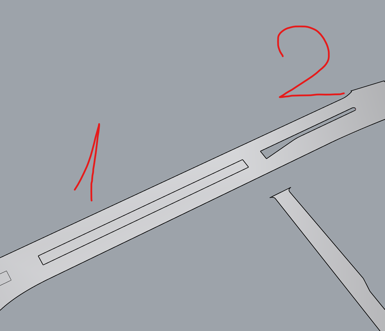

Hey there,
I have a problem (picture attached). I use PlanarSrf command to create planar surfaces but with this particular case for some reason with situation captioned as 2 PlanarSrf detects inner boundaries and with sutuation 1 it does not. What could be the problem? I checked and pretty sure every curve is planar and closed.
 ![Screenshot 2025-08-11 211034](https://global.discourse-cdn.com/mcneel/uploads/default/original/4X/d/9/6/d96e07ac8bb6d625432972a696008f08d03924d7.png)
UPD: I discovered that the issue might be that with the situation 1 the outer boundary is curve and the inner is polyline. Apparently you can’t create PlanarSrf that way. Is there workaround for this problem?
Thank you in advance.

The curve at 1 is either not planar, not closed or both. Can you send the file?

maybe selfintersecting, just post the geometry no more guesses needed?

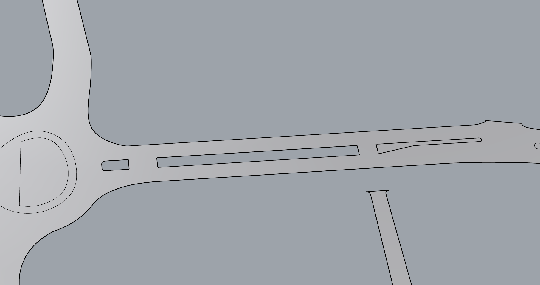

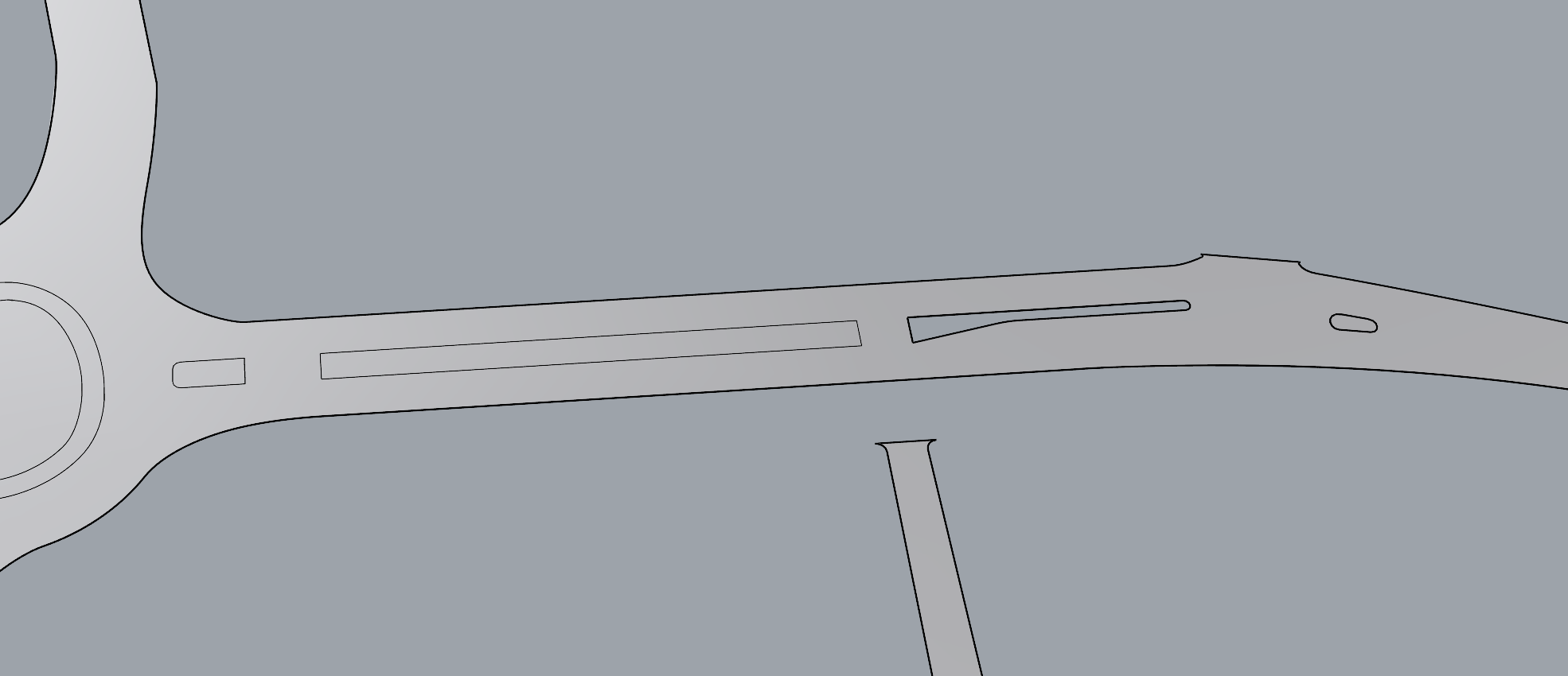

Sorry, forgot to attache the file. And I also discovered that PlanarSrf command will work if I exclude some inner boundaries out of selection (shown on pictures).
 ![image](https://global.discourse-cdn.com/mcneel/uploads/default/original/4X/7/e/5/7e542b131aa12f41c8ed22ba6206b5670f5db8fb.png)
 ![image](https://global.discourse-cdn.com/mcneel/uploads/default/original/4X/6/7/2/67222caf885d7f9fc8f3e0ca59d6996bd51a92ae.png)
[PlanarSrf Issue.3dm](https://discourse.mcneel.com/uploads/short-url/avrL72AF0AhGdkQockIsyJYhpLn.3dm) (126.8 KB)

thanks for the file. At tolerance 0.1 the result is as expected.
[RH-88817](https://mcneel.myjetbrains.com/youtrack/issue/RH-88817) PlanarSrf from curves fails

It really does work that way. Thank you so much.
