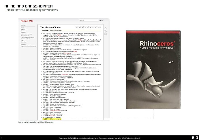

> [@TomTom](#):
> Why should Rhino become so much better with Meshes, if its purpose is to create Nurbs models?
Purposes evolve, Rhino has come a long way since 2007:
 ![2023-08-23 12_25_01-210911_Grasshopper101_CPH.pdf - Adobe Acrobat Pro (64-bit)](https://global.discourse-cdn.com/mcneel/uploads/default/original/4X/8/3/c/83c95e42635dac358e28f75834e9d6b2e94a5353.jpeg)
 ![2023-08-23 12_25_24-210911_Grasshopper101_CPH.pdf - Adobe Acrobat Pro (64-bit)](https://global.discourse-cdn.com/mcneel/uploads/default/original/4X/d/e/c/dec13dc4c68cb15ae1f44a0bca6d8dea112b7a0f.jpeg)
(Slides from my Grasshopper101 BIG course)
