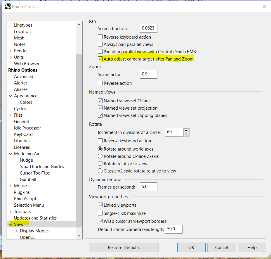

One thing to check that might be different, is in Options > View for both V5 and newer. Is “Auto adjust camera target after Pan and Zoom” checked?
Checked is default.
Hi, V5 and V7 ticked in both.
Steve

V7’s view rotation is different than V5’s. You will find yourself having to reset the rotation center more often than in V5. To set the rotation around a selected object, simply do a Zoom>Selected when it is selected.
You can make Rhino 7 do exactly what you want if you use the Gumball - in Gumball>Settings, check “Rotate view around Gumball”. When you select an object, it will then always rotate around the selected object’s bounding box center.
