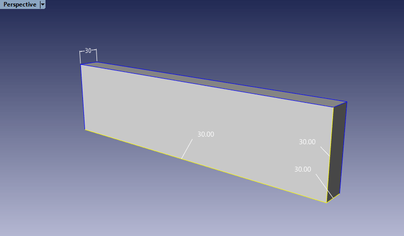

Why Rhino can’t deal with this simple filleting task? 2018, Rhino 6
Fillet a corner with 30 mm radius of a box 30 mm thick:
thanks, Tobias
Because the rolling ball has the same radius as the surface it’s trying to follow.
It completely deletes that surface.
If the radius is less than 30, or you model it another way, you can do it.

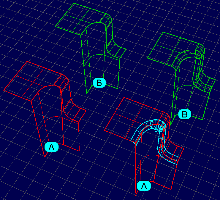

Hi Pascal
Another thing (maybe a simpler project) that may help in several cases if this, IMO.
mergetrimmed.3dm (221.5 KB)
Being able to merge (back) trimmed surfaces.
This is a little piece of a polysurf I’m working on right now.
I had to split the tapered surface to be able to sub-select and edit it.
But now I am no more able to use FilletEdge on it.
( Surfaces “A” )
If I could merge the surface back into a single polysurf ( Surface “B” ),
then FilletEdge would work.
… Makes any sense ? :slight_smile:

Hi Emilio - it makes sense as far as it goes but I guess that is fundamentally the same problem for the filleter as I described above. - merging as you suggest might be a good thing to be able to do regardless and I see how it helps in this case, but that is just the circumstance. (that said, in general things behave better split at tangents)
Sure !
Yes, exactly.
I think that merging surfaces would be mostly a workaround to be able to use other commands.
But somehow, we are used to look for workarounds … :slight_smile:
