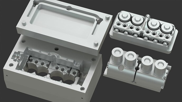

If I’m designing a plastic housing to be injection molded, the design needs to be 100% as it’s intended to look before handing over to the toolmakers. They don’t want CAD that’s 90% finished with instructions on how to do the other 10% (unless we’re talking about surface finishes) - the responsibility for the design is in my hands, their job is to machine the mold using the cad I give them.
Then there’s 3d printing where especially if it’s a jig or a quick prototype - I want the part coming off the printer without needing to do post work.
If a fillet gets the job done - I’ll use it. I don’t compartmentalise my cad tools into ‘right’ and ‘wrong’ tools - everything gets used to get the design where I need it to go. Fillets in solid modellers have a lot of flexibility and let me focus on design rather than manually building a surface when a fillet achieves the same thing.
Edit: Also in the concept phase of a design, fillets are very useful to make quick changes to geometry.
