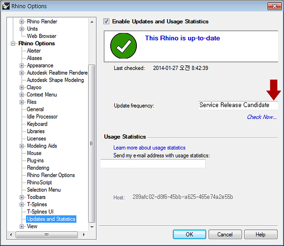

I have never been dropdown button for change “Service Release Candidate” to “Service Release” in the Update frequency.
Do you know the reason?

I have never seen the button in Rhino V5 SR0, SR1, SR7.
Anyway, I could not change it. Dropdwonbutton.zip (5.1 MB)

It looks like you are running Korean Windows with English Rhino, is that correct? Are you using large fonts in Windows?—

Yes. I’m using Rhino in Korean Windows 7.
No. I’m not.

This is apparently a known bug that we haven’t fixed yet. To work around the problem, click in the drop-down box with the text “Service Release” and use the down arrow key on your keyboard to change it to “Service Release Candidate”, then click OK.
