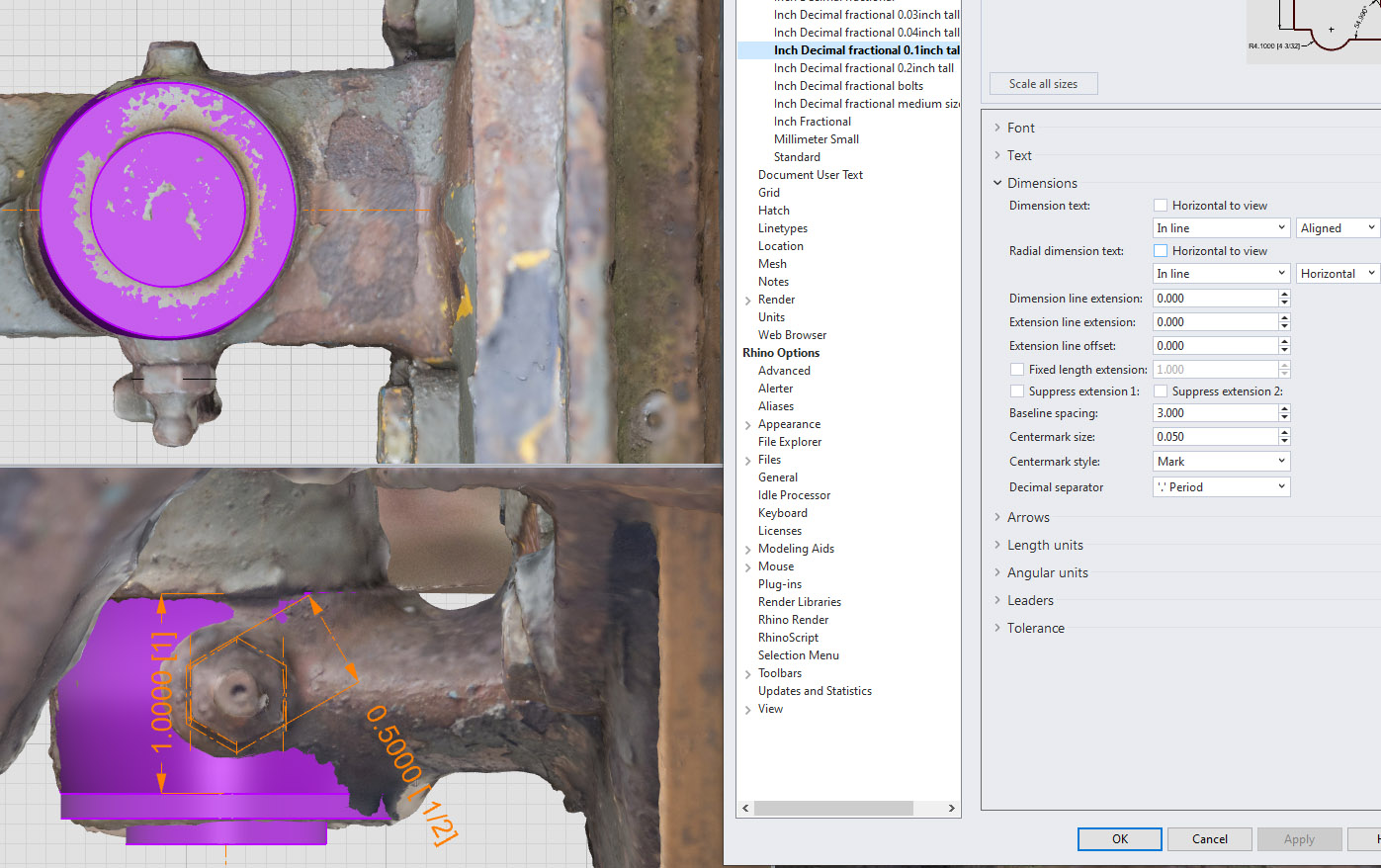

V8
 ![dim between arrows](https://global.discourse-cdn.com/mcneel/uploads/default/original/4X/d/d/a/ddaa12536bd225e3fd7e615c8d7f953531de52ef.jpeg)
Thought I had all the settings sussed but this dim data wont go inside the arrows, when it will in V5.
what setting fixes that ?
 ![dim between arrows settings](https://global.discourse-cdn.com/mcneel/uploads/default/original/4X/8/6/4/864b7532d765695e9b34a9452d9626dfee6f4b56.jpeg)
It was drawn new in V8, not imported from V5.
[dims to be inside but how .3dm](https://discourse.mcneel.com/uploads/short-url/7M48KZhA6NokabG2VBtrmHoxG2P.3dm) (2.2 MB)
Cheers
Steve

It is under Dimension Lines within the Annotation Properties. Pick In Line from the dropdown.

@jeremy5
Thanks, fo file properties annotations, found that, done that, fails, close and reopen file, fails.
 ![in line solve outside arrows dims](https://global.discourse-cdn.com/mcneel/uploads/default/original/4X/1/1/7/117b47cca92074f39813cd9eba222ad9a7ee70b1.jpeg)
 ![in line solve outside arrows dims fails](https://global.discourse-cdn.com/mcneel/uploads/default/original/4X/1/8/4/184d4168e44a6d3d4852ed3b39966ac0a9a5ce6c.jpeg)
and it is using that style. 0.1 inch decimal.

Sorry, I misunderstood what you were asking for: that setting is to set the text in the line or above it.
This is the one I think you want:
 ![image](https://global.discourse-cdn.com/mcneel/uploads/default/original/4X/c/d/7/cd7bb67885b1f4997f876bb45b0e6c2107047780.png)

@jeremy5
part success now, but cannot get numbers **above** the line, text gap value did nothing.
So what is text gap operating on ?
**arrows clashing with numbers now.**
odd this as I thought I had got all my dims matching V5.
 ![part success](https://global.discourse-cdn.com/mcneel/uploads/default/original/4X/c/3/2/c32cba583a2cbf6100a857eae2b47310bc264813.jpeg)
 ![V5 dim behaves](https://global.discourse-cdn.com/mcneel/uploads/default/original/4X/2/a/3/2a3b1f7b56a2371c3c0dd52534fcf429cd326d55.jpeg)
update
SOLVED IT, its the next section down. (not very logical the dims settings layout)
 ![dims above arrowd solved](https://global.discourse-cdn.com/mcneel/uploads/default/original/4X/3/9/0/390537ad364648e31866dc054fc8e118944a1a09.jpeg)
