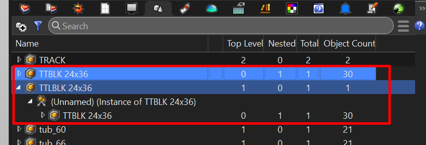

@mary Do you typically make the block in model space in a seperate Rhino file and then insert it into the project file on the layout? I did this and I am getting odd behavior in the Block Defininitions list.
Hi @larchitect,
This is above.
The block geometry should be made on the layouts, and then defined your block.
Rhino designates specifically annotations as being model or layout.
So they need to be made in the space they will be used.
Curves are more forgiving.
As a general rule, if you make your title block geometry, curves and text on the Layout, then Block them together, you will be in good shape.
When you have the title block on the layout, copy the layout, ImportLayout to another model, or customize your template to include the layout - all are good ways to share the layout and block.
