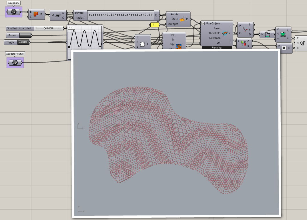

You could use Kangaroo
 ![image](https://global.discourse-cdn.com/mcneel/original/3X/7/e/7e9d6e0e6a3e358eb8523475f4593c4a11e0f8ad.jpeg)
Here a way
[gradient\_circles\_02\_LD.gh](https://global.discourse-cdn.com/mcneel/uploads/default/original/3X/4/a/4ae8330b65f74bf94503888b13b5ce7e5d141798.gh) (17.1 KB)
Another way of doing
 ![image](https://global.discourse-cdn.com/mcneel/original/3X/4/f/4f6846a597f1f33cfdc95364815c78cec66afded.png)
 ![image](https://global.discourse-cdn.com/mcneel/original/3X/1/2/126fd0fad95f73cec15902ae489f2e8fb4bf9eb4.jpeg)
[gradient\_circles\_03\_LD.gh](https://global.discourse-cdn.com/mcneel/uploads/default/original/3X/2/5/25f2ec4e9376a8aabc26d8c9817522041cfdb771.gh) (12.9 KB)
