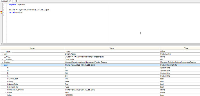

It looks like he’s using the EditPythonScript editor, but it works fine there too:

this is rhino’s editor. is it different to grasshopper’s? it looks has many functions.
The main differences is that it comes with a debugger, the documentation tree, and has tabs (and of course targets the Rhino document instead of the Grasshopper document). They both share the same runtime though, meaning that they can both read/write to sticky for instance.
