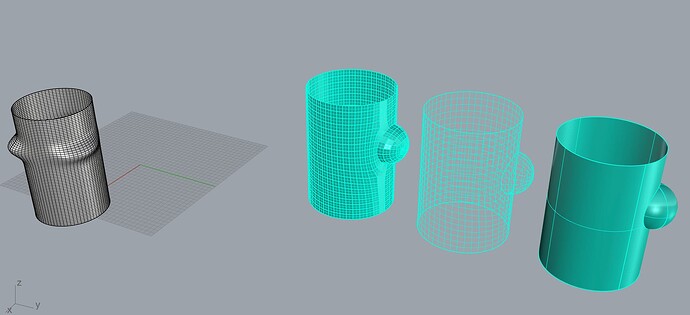

I have a quick question. The script works perfectly when I use a simple surface as input, but when the geometry becomes more complex, it turns into a polysurface, which no longer works with the input as expected. Most of my models tend to be a bit more complex than single surfaces.
Do you happen to know of any methods or workflows that would allow me to use these more complex shapes as inputs? I was thinking of possibly slicing the geometry using radial and horizontal planes to generate points in space, which I could then feed into Grasshopper.
this is the model I want to use as input (green)
Any suggestions or ideas would be greatly appreciated!
wavy loft pattern Edited v1 works on surfaces.gh (14.6 KB)
wavy pattern base surface.3dm (7.6 MB)
I see three green shapes :question: Which one?
Your GH file refers to none of them. :frowning:
So I added a ‘Brep’ param set to the the shape on the right, then added DeBrep to get the brep faces (surfaces). There are three because of a seam on the sphere shape.
Obviously, a brep is not a surface.
And your method of lofting interpolated curves fails to account for holes.
:rofl:

Apologies for any confusion. All the green models are actually the same; I was just experimenting by converting them into different formats like Mesh, SubD, and using QuadRemesh to see if Grasshopper would accept them as input, but unfortunately, none of those worked.
Currently, when I needed to create ridges on a polysurface, I had to slice the target geometry with planes to extract curves, then sweep profiles along each curve individually. It worked, but it was very time-consuming — which is why I was hoping to streamline the process using Grasshopper.
The main challenge I’m facing is that I can’t directly input a model like this into the script, since any model with little complexity it is for Rhino a polysurface. If you have any suggestions or alternative approaches, I’d be very grateful.
