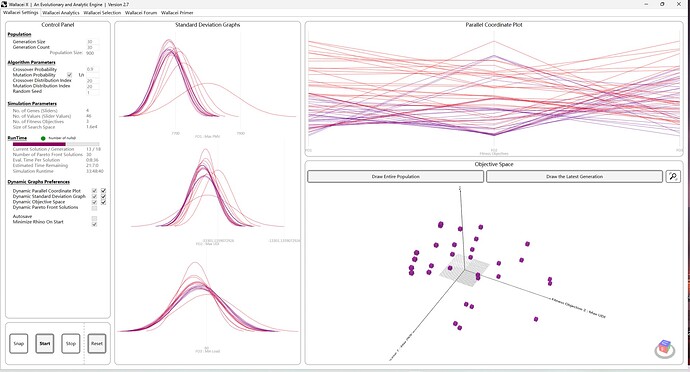

When I was conducting Wallacei multi-objective optimization, after running for a day, a run code box popped up displaying [Process exited, code 0 (0x0000000) 1 can now use Ctrl+D to close this terminal, or press Enter to restart]. What does this mean? Do I want to click on it?
And the time required for each generation of my calculations is increasing, from 2 and a half minutes at the beginning to about 6 minutes now. What is the reason?
it appears to me that this is related to the daylight simulation you are running. I need more information to be able to help you.
Thank you very much!! This issue was resolved after changing the connection of the honeybee room component and simulating it again. I think it should be a problem that occurred during the modeling process.
