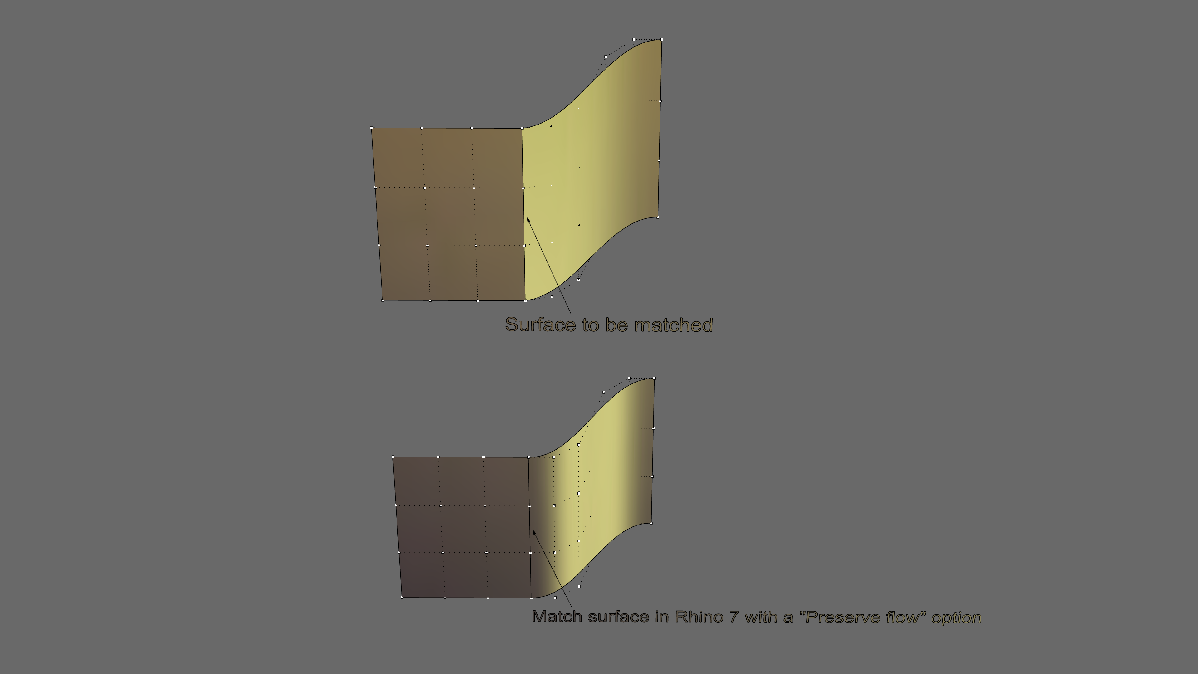

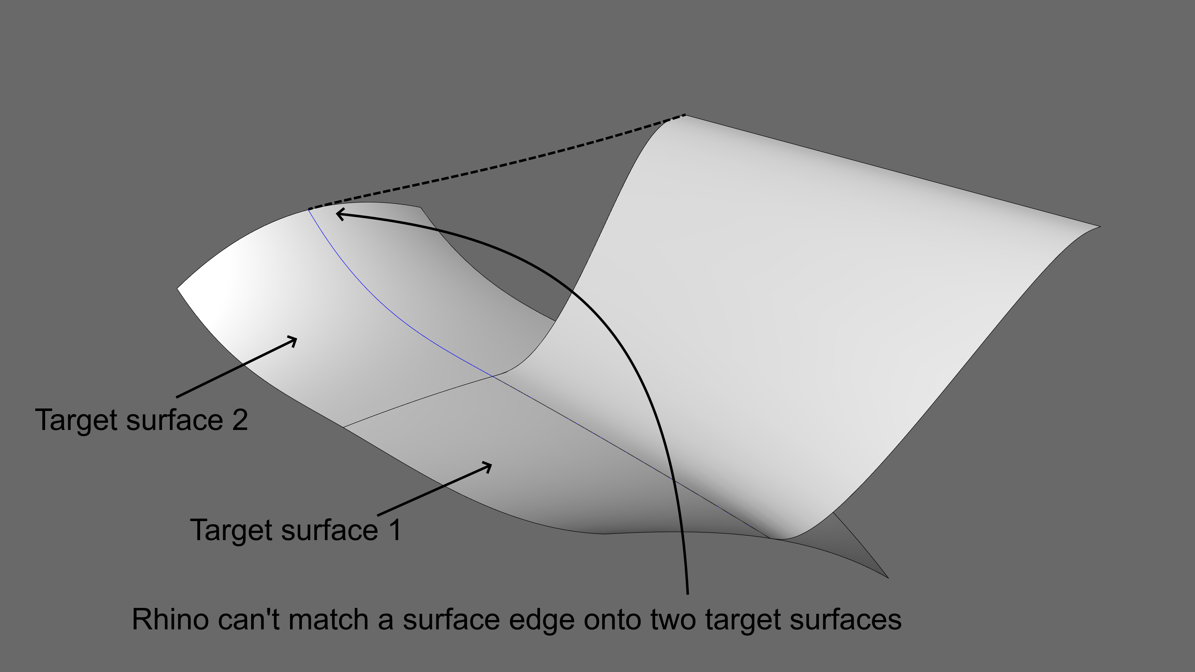

Just a prediction:
 ![Match surface G2 - Preserve flow 2](https://global.discourse-cdn.com/mcneel/uploads/default/original/4X/1/2/9/129a3c9b175d98f2ca9dbdab51fd5e14a82b55c4.png)
G2 continuity with 3 options:
 ![Match surface keep flow](https://global.discourse-cdn.com/mcneel/uploads/default/original/4X/9/3/0/930e6dbc241729cea4c555e8a5dd8633607598f1.png)
 ![Match surface G2 - Preserve flow 1](https://global.discourse-cdn.com/mcneel/uploads/default/original/4X/c/3/c/c3c9a4c8b859b5226fa7d1b6ded34562c8020e14.png)
 ![Match surface 2](https://global.discourse-cdn.com/mcneel/uploads/default/original/4X/f/5/2/f52769ec6a50db84401dda8b3fbcd341103c379e.png)
 ![Blend surface handle - match angency 1](https://global.discourse-cdn.com/mcneel/uploads/default/original/4X/e/1/0/e10c29d92b5b16d9c847aa78b574919bbe6711e6.jpeg)
 ![Blend surface match edge direction](https://global.discourse-cdn.com/mcneel/uploads/default/original/4X/5/6/4/56499e53613cda1ecc2f259c0eac59389b2d5184.png)

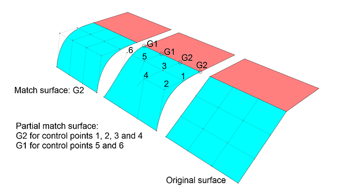

 ![Partial surface match](https://global.discourse-cdn.com/mcneel/uploads/default/original/4X/8/c/0/8c07d562e316e98b69d229d0f4f5f42b53f690c0.png)

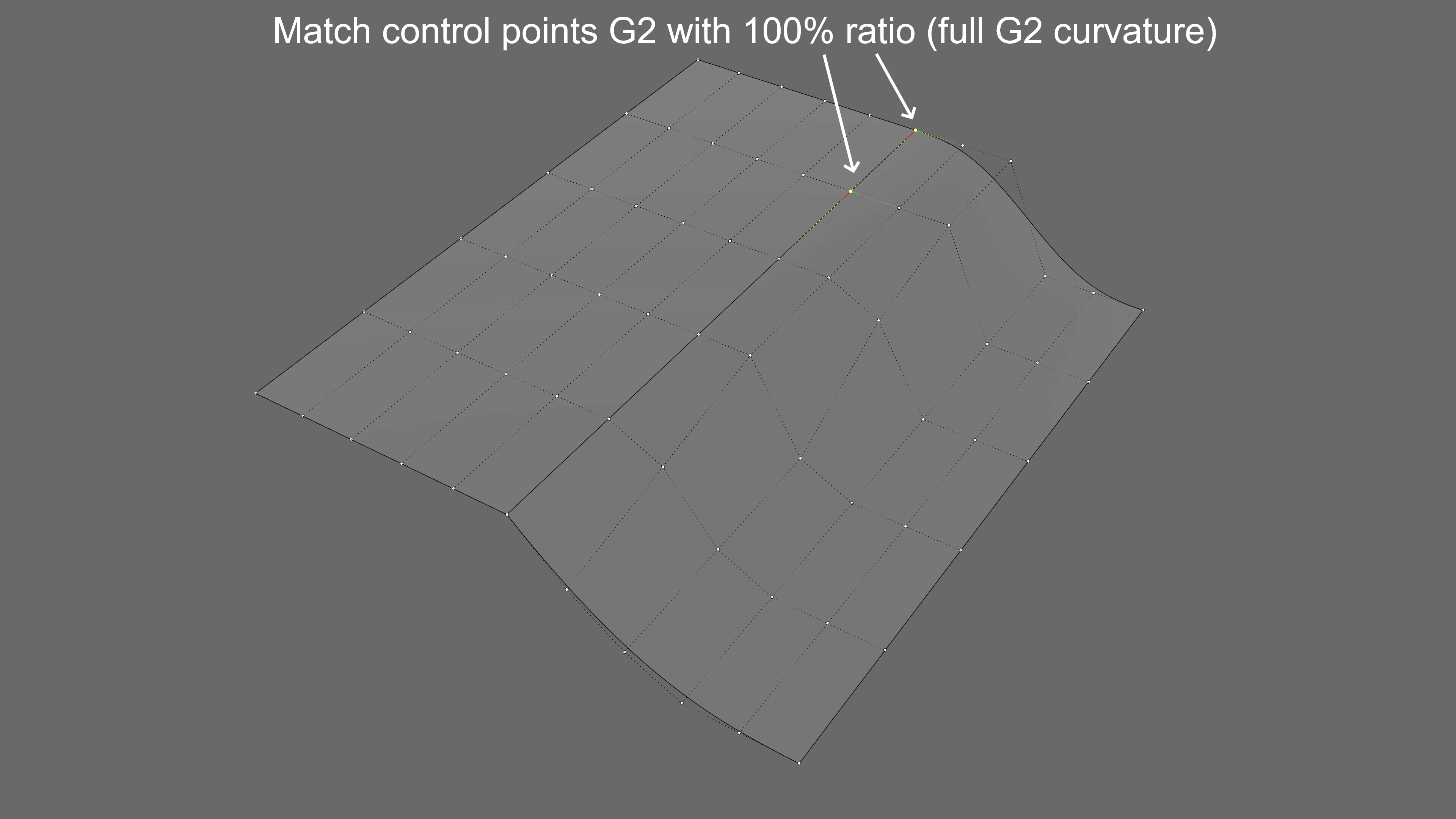

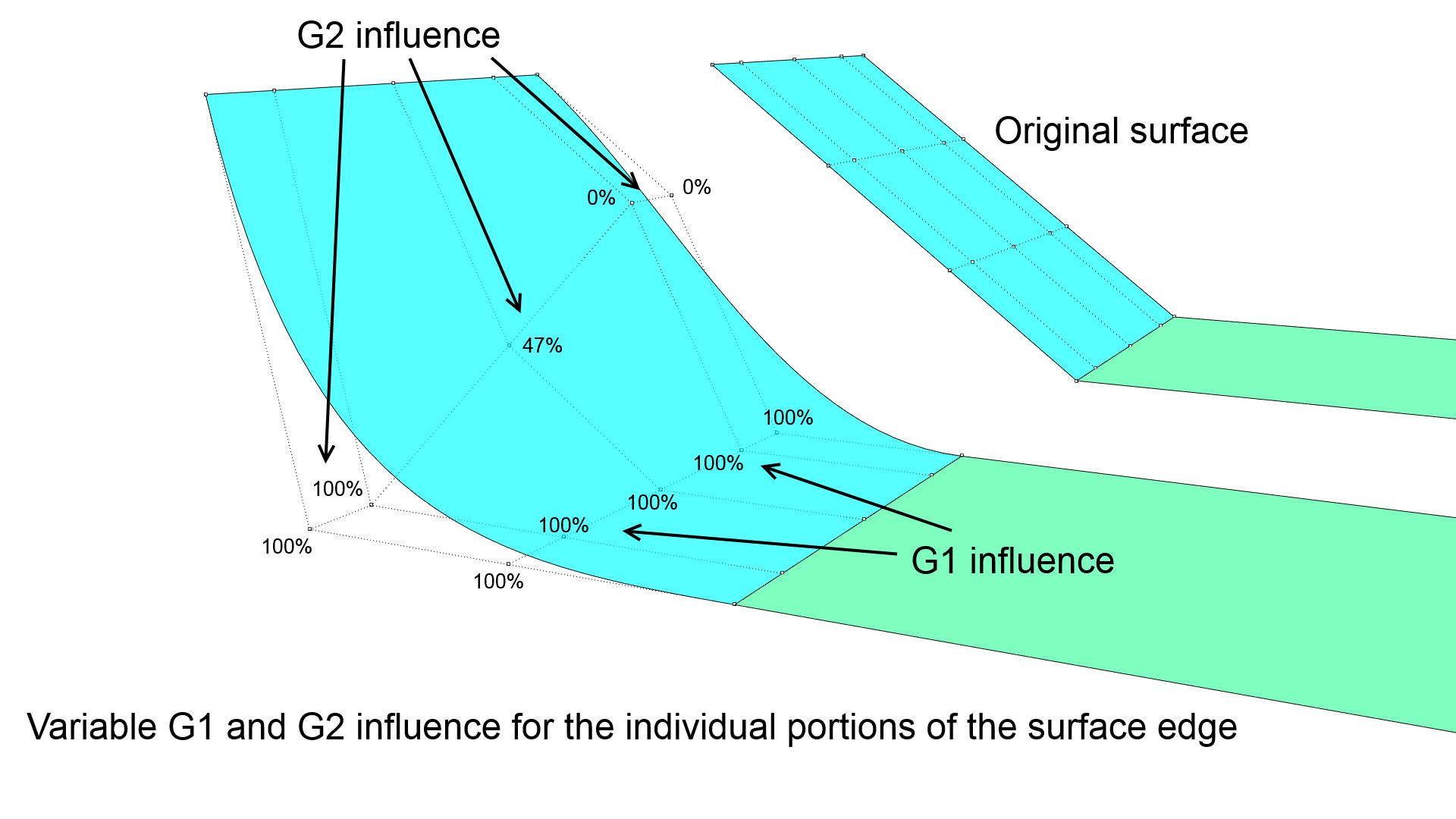

Imagine being able to match individual control points instead of the entire surface edge… Dreams come true.
 ![Surface match influence](https://global.discourse-cdn.com/mcneel/uploads/default/original/4X/0/9/5/095f9a25fa7fa40ac53b073e92690fd5f98ad355.png)
 ![Match control points G1 with 50% ratio](https://global.discourse-cdn.com/mcneel/uploads/default/original/4X/4/b/8/4b85c7eb66121bdeb428155969f14e0dd298b8e0.png)
 ![Match control points G2 with 75% ratio](https://global.discourse-cdn.com/mcneel/uploads/default/original/4X/1/c/a/1ca15fd88310eb48f0647480b73e9c7ba7bba18b.png)
 ![Match control points G2 with 100% ratio](https://global.discourse-cdn.com/mcneel/uploads/default/original/4X/9/a/5/9a574d150b7f3c40adca83e5d32d359a0f87b5ba.png)
 ![Match surface with 75 percent G2 influence](https://global.discourse-cdn.com/mcneel/uploads/default/original/4X/1/7/1/1713561668b9bf24f9628184942b36c5f6328d12.png)

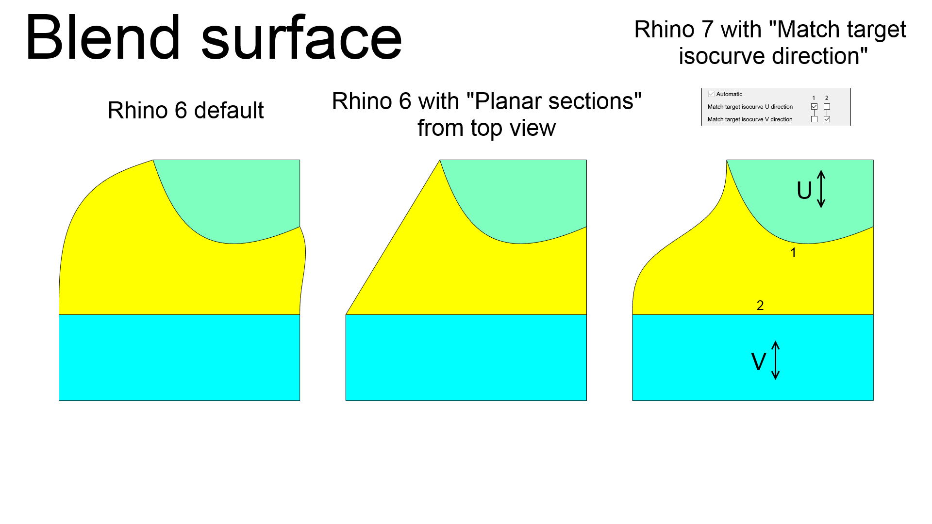

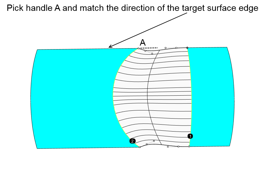

Two separate options for “Match target isocurve” will easily fix the current ultra mega flawed single common option that matches U and V directions simultaneously…
 ![Match target isocurve direction](https://global.discourse-cdn.com/mcneel/uploads/default/original/4X/8/4/5/8450e3e4cad5da9c36c59401d4f399165ba4d3e1.png)
 ![Blend surface - Match target isocurve direction](https://global.discourse-cdn.com/mcneel/uploads/default/original/4X/3/e/8/3e8ccb9f744493ce83b897b3944bdbfe42b67088.png)
These suggestions were posted in various topics since the Rhino 5 time…

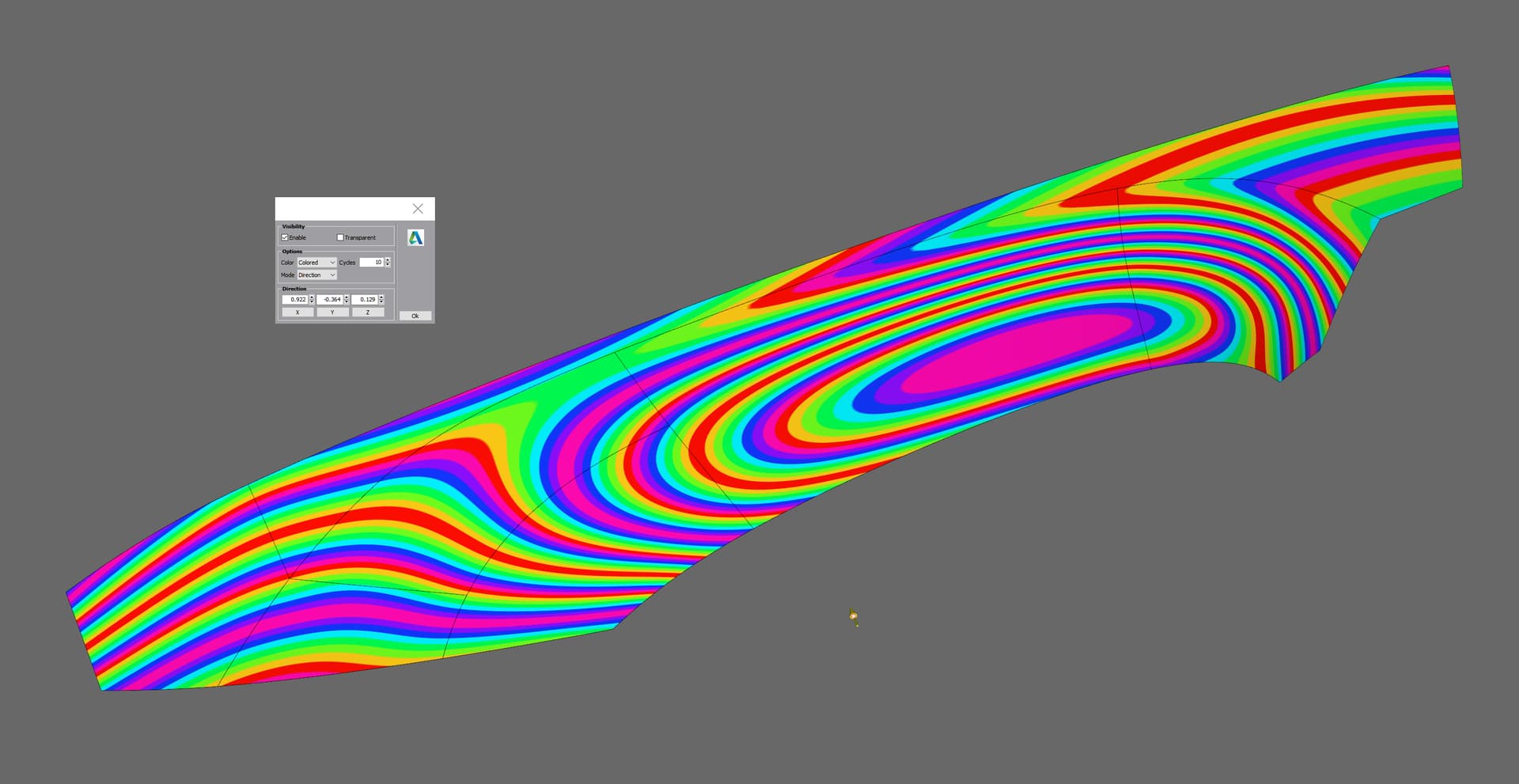

Regarding the new Static zebra in Rhino 9, could someone capture a nice video where all the new options are shown and the way they affect the analyzed surfaces?
I would like to know whether the Static zebra lets the user set his/her own custom colours (set by RGB code or sliders), number of colours, and arrangement (which colour is next to the other colous). For example, here is how the Static zebra looked like in VSR for Rhino 5:
 ![VSR light lines](https://global.discourse-cdn.com/mcneel/uploads/default/original/4X/0/4/b/04bd30858c009c3a59810216378b203fc1324047.jpeg)
It used the following 8 colours (at least when I extract their RGB codes with a graphics program from this old screenshot):
0, 50, 250
136, 0, 250
250, 0, 175
250, 11, 0
250, 200, 0
113, 252, 0
0, 250, 75
0, 240, 252
![VSR light lines - 8 colours](https://global.discourse-cdn.com/mcneel/uploads/default/original/4X/f/b/9/fb9d70116d8d95394ff4a60e1918aba9268c854b.png)
While they provide a nice variety, as a colour blind person I have some trouble with visually separating some of the nearby colours, so the ability to set custom colours is welcome. also, think about the option to add darker thin lines to distinguish the main colours of the light lines.

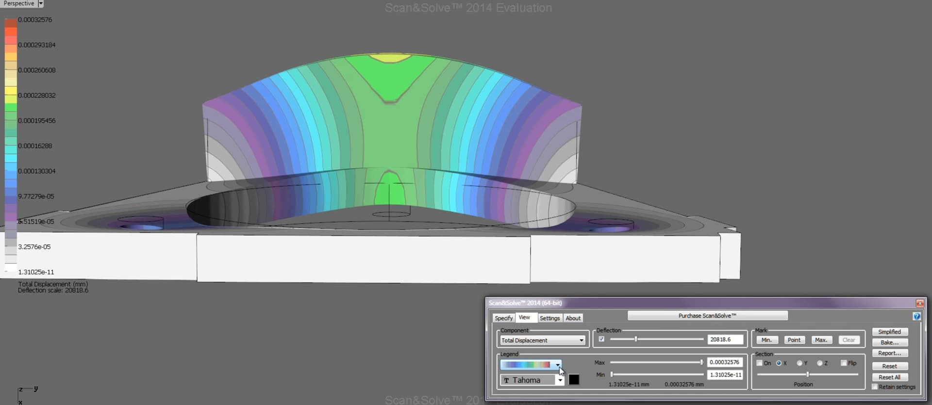

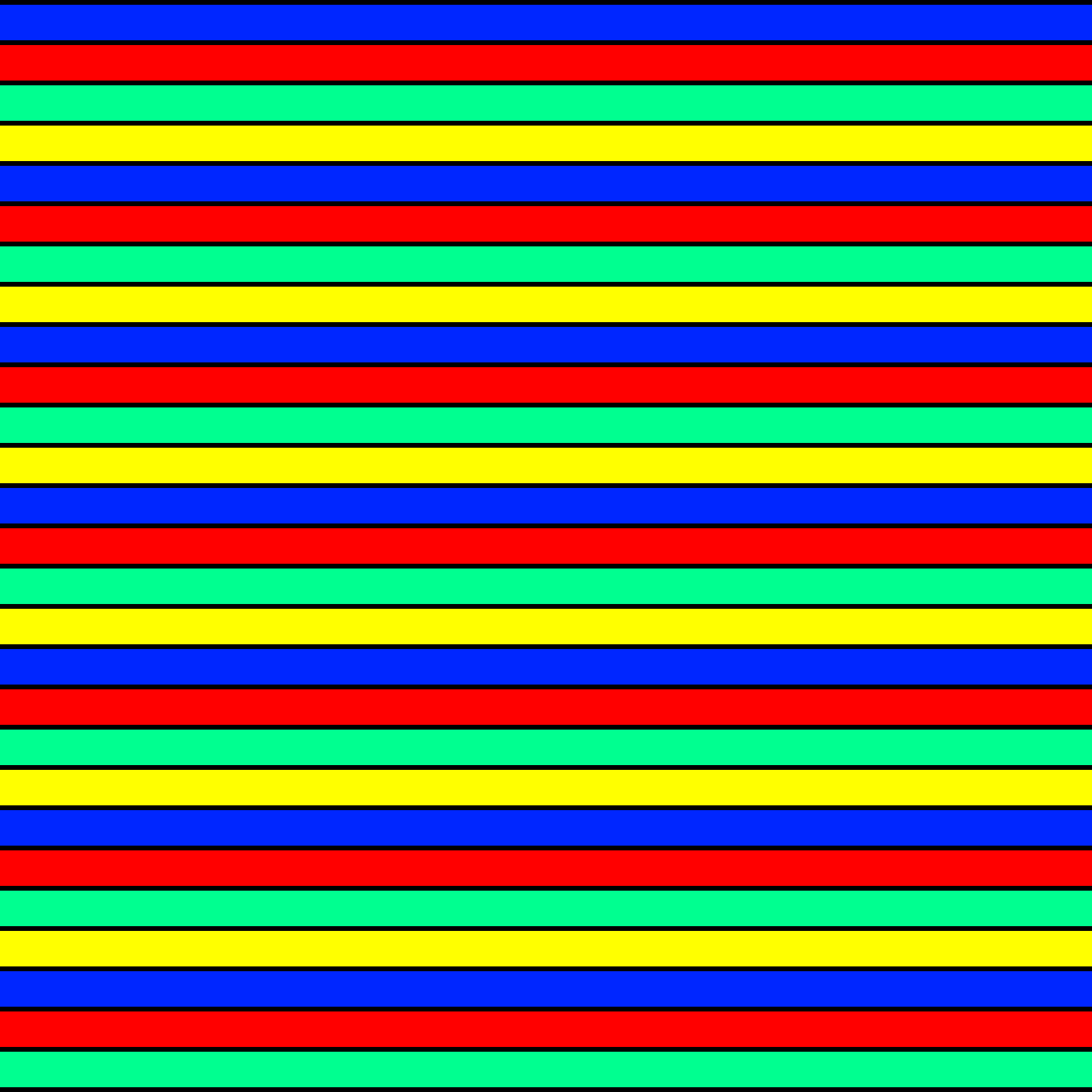

## The demo of the “Scan and solve” plug-in years ago used these colours instead, separated by thin darker lines to distinguish them better: ![Scan and solve colours](https://global.discourse-cdn.com/mcneel/uploads/default/original/4X/e/e/a/eeaabd602b8e8d959da49ce2562aa5fa625f1b41.png) ![Scan and solve colours 2](https://global.discourse-cdn.com/mcneel/uploads/default/original/4X/3/4/a/34ac828bc3f831994fa0649ca1223b7f2aee54dc.jpeg)
My custom display mode called “Light lines” uses this image as an environment map:
[lightlines.ini](https://discourse.mcneel.com/uploads/short-url/mDFmKjnHtQELI3dPthYOye2pt6E.ini) (13.5 KB)
 ![Light lines 1](https://global.discourse-cdn.com/mcneel/uploads/default/original/4X/8/b/f/8bf2ce9b37f8ec02c1109f6c12a56b2d5445a992.png)

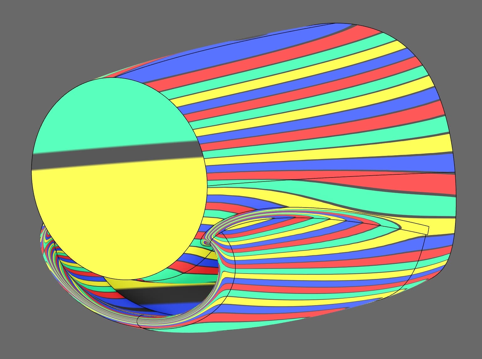

They appear lighter in the viewport:
 ![Screen Shot 03-06-25 at 05.39 PM](https://global.discourse-cdn.com/mcneel/uploads/default/original/4X/0/8/f/08f932b6ae37b569b933c9cc606d8ef42923cd37.jpeg)

The new zebra command does not currently have inputs for setting custom colors. That said it is possible to define up to eight different colors as inputs to the low level display code. I wrote a sample GH definition that exposes the new zebra functionality at
