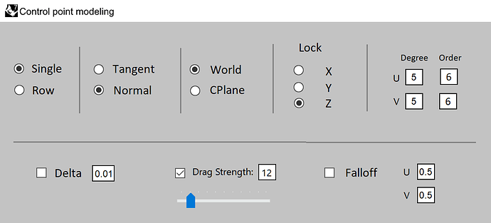

Hello Bobi,
this is going in a good direction, Control Point modelling is a great weak point at the moment!
One question, why would you want a “Drag Strength” toggle for each mode?
As a preset? So you dont have to switch it on/off when changing modes?
That would be a nice idea, as Im a huge fan of “Drag Strength”, I actually prefer it over “Delta” in most cases.
What about toggling "Drag Strength with a hotkey? Because in your proposal it feels a bit visually overloaded.
And please dont forget “Direction Locking”, “Degree/Order Change” and “Delta” value!
I would also prefer to have Normal and Tangent as seperate modes. This way CPs can be touched and moved in **one click** with selection by proximity.
Visual indicators like a gumball could be solution. But that might require selecting CPs first, then either picking a tangent or a normal and modifing them, which is double the amount of clicks. What are your thoughts on that?

My proposed “Control point modeling” is in a different direction, as my example above shows. 🙂 It’s strictly focused on manual control point manipulation rather than rebuilding the surface’s structure. The general idea is to be able to set custom Drag strength to certain Drag modes so that the user could benefit from using two different settings at once. For example, if Gumball uses the CPlane coordinates and the “CPlane” option in the “Control point modeling” window is not active, then the user will move the selected objects or control points with Gumball with 100% drag strength. However, if the Drag strength for the “Control polygon” setting is active, then moving the selected control points via the proposed tiny arrow handles next to each control point (similar to what Alias uses) will be affected by the Drag strength’s percentage, so that the user will be able to make extremely fine adjustments via those handles while he or she could still use the Gumball for moving with 100% drag strength.
 ![Arrow%20manipulator%201](https://global.discourse-cdn.com/mcneel/uploads/default/original/3X/9/d/9dbc4830b6e8b9f255e60bb19e69e737d8d977e0.png)
> [@norbert\_geelen](#):
> And make that a dockable panel or toolbar like selection filter!
I made my pop-up window based on copying some UI elements from existing Rhino tools, so it’s a bit larger than what I would call optimal utilization of space.
If I was in charge with decisions about the GUI of Rhino, I would definitely look into the possibility to implement a function to auto-hide certain windows that could be easily accessible via simple hovering with the mouse near the left or right edge of the screen. Solidworks uses those for many years and they are a great space saver. For example, its “Solidworks Resources” panel (similar to Rhino’s “Properties” panel) automatically hides when not in use, leaving only several small icons stacked vertically on the right side of the screen. In Rhino, those could be the main Object properties, Materials, Layers etc. Clicking one of those icons, for example, the layers, should open the properties panel with the Layers tab in focus.

> [@Rhino\_Bulgaria](#):
The UV setting is not rebuilding the surface’s structure. Its an ICEM thing, where the Surface’s structure and shape remains the same, you can simply add oder remove CPs. Just like the VSR plugin.
I can see the benefit of setting a different Drag Strength for Gumball and for CP-Modeling, just maybe not for EVERY mode. But I really like your concept.
I love the little arrows that you are showing in your proposal!
