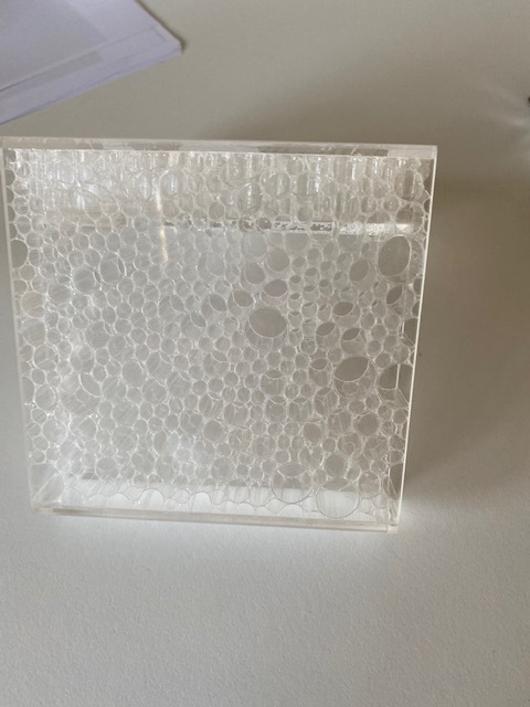

I’m working on an interior project were I need to create two very complex material which i tried to create using geometry but i have to say that it almost made my computer burn.
I’m trying to render an office room with two different proposal of of “Honeycomb” separation on the walls, image in attachment.
https://www.architonic.com/en/products/honeycomb-panels/0/3231469/1
Do you have any idea how to create it whitout having the computer explode?
I’m working with rhino 7 and vray 5.
Cheers!
honeycomb1 (1) honeycomb1 (2) honeycomb1 (3)
honeycomb2 (2)
