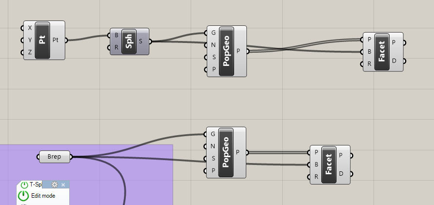

I was trying to create something similar to the structure in the below picture
My approach was populating T-spline surface and then applying the vorX (voronax form from point cells) this worked for some surfaces but it dosen’t work for the surface I want it to be applied
What could be the possible problem here
Also if there are any other approaches to create something like in below picture?
Any form of help is much appreciated !!
 ![4278](https://global.discourse-cdn.com/mcneel/uploads/default/original/3X/0/3/03231b98614e41c81fe65abe48215b1aa08d60d7.jpeg)
 ![image](https://global.discourse-cdn.com/mcneel/original/3X/1/6/16ba6f72e41717f59dde2e7ffa4ce96970c68ce1.png)
 ![image](https://global.discourse-cdn.com/mcneel/original/3X/0/9/095010bcd6a39e0a6b5400995255ac3b8081155b.png)
[voronoi on surface.gh](https://global.discourse-cdn.com/mcneel/uploads/default/original/3X/2/e/2edf2b239c19714db6171b59e42a8d3b97eb666e.gh) (4.1 MB)
(internalised Breps)

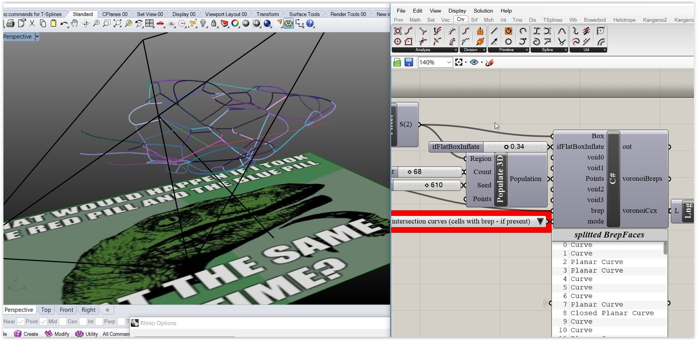

You are usind some add-on(s) that I don’t have. Anyway I have stuff for that type of task. it’s done with C# … but so what? That’s not the issue here at all. See this? - **shown with clip for clarity** (a random TSpline blob VS Vor cells out of points in the blob’s BBox):
 ![Screen%20Shot%20066](https://global.discourse-cdn.com/mcneel/uploads/default/original/3X/8/4/8478b33432df8df478520ccdceac7de7c0d9d26d.jpeg)
The big issue here is that’s VERY slow … meaning that violates any known rule of interactive parametric usage. Even the Brep (blob) / Brep (vor Cells) sections ( **as Curves** ) option available is very slow (but less so I confess).

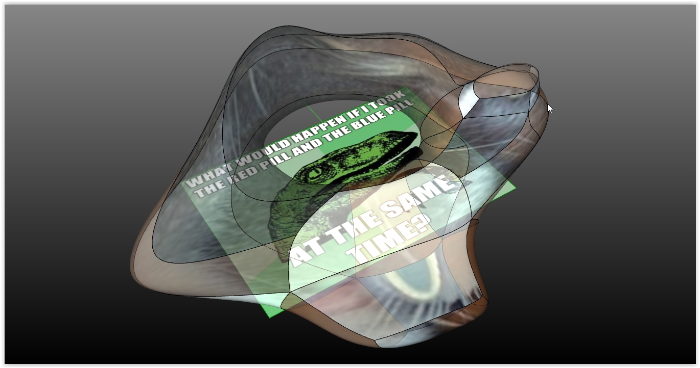

 ![Screen%20Shot%20067](https://global.discourse-cdn.com/mcneel/uploads/default/original/3X/0/b/0b232d09eecafbfc85cf2264e7b13e2f7057543d.jpeg)
The other issue is that the former works with Blob’s BrepFaces VS the Vor Cells meaning that may exist pieces of the same face but due to a trim with another (adjacent) Vor Cell. See what I mean (spot the “long seam”):
 ![Screen%20Shot%20068](https://global.discourse-cdn.com/mcneel/uploads/default/original/3X/8/5/856bd414714af369224deb88fe2dffe482c463a3.jpeg)
This means that even more time is required for joining the pieces.
And all that while the pieces are not (yet) thickened nor are treated as windows
So if you are willing to pay a BIG price by waiting the computer to finish the job, **notify**.

Thanks for the info [Pfotiad0](https://discourse.mcneel.com/u/PeterFotiadis)
I was using VORONAX\_GH plugin to create the pattern
> **[Voronax\_GH](https://www.food4rhino.com/en/app/voronaxgh)**
> This is a Grasshopper Component based on our existing eVe | voronax plug-in for Rhino. The Component was developed in cooperation with&
I’m trying to create the expected final result being faceted than being curved surfaces( at least less curved like in the photo I have attached above)
I don’t mind the waiting time since this is regarding an academic project and I’m stuck in the process. Also, time is running out.
Could this C# create something similar and do you mind posting it here if so?

It works but kind of damaged
 ![image](https://global.discourse-cdn.com/mcneel/uploads/default/original/3X/8/e/8e3fa1f2aaacea8312ab85218b9fac07d797fbb7.jpeg)
What I need is exactly this kind of division on my surface. I prefer edges being totally straight. I’m trying this for weeks now and no luck yet. As you mentioned it was very time consuming and become non-responsive often.
But It’s too late to turn back, have to finish this somehow. Is there any help, that would be very appreciated.

I tried the GH facet dome component as well, but the result was like below
 ![image](https://global.discourse-cdn.com/mcneel/uploads/default/original/3X/a/b/abc0be72a1089d8dc0e2f61c311d28d938731aae.png)
 ![image](https://global.discourse-cdn.com/mcneel/original/3X/6/2/628c4ba0b120746b2ed5a3d5c6bc8d10154a5abd.png)
It works for the sphere, but not for the surface I wanted… does this c# facet dome component works on surfaces like this?
About the C# component, It would be very useful if it exports the curves lines and centre points and cell as the output parameters. otherwise paneling on the surface would be very hard task.
