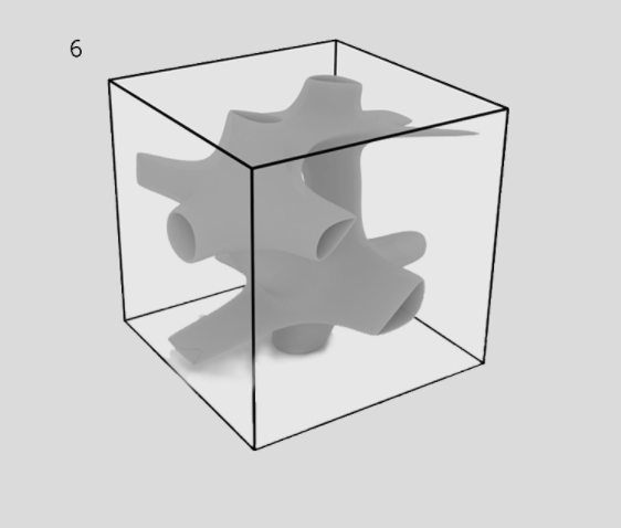

May I know why the script does not work on this?
Screenshot 2020-05-18 at 20.59.16
voronoi.gh (15.6 KB)
Check corelations of units first.
What 's the reason that the unit doesn’t work?
Your Box geometry is not internalized, the orange wires and components are a clue.
It happens that some definitions works only for certain types of units.
after internoliazed, it become like this
Why do you have numeric sliders connected to geometry inputs on Pop3D and Volume? And the slider connected to Scale ‘F’ should be REAL, not INTEGER. The whole model is a bit of a mess.
Red baloons indicates usually wrong inputs. As Joseph is saying - check your inputs first.
voronoi_re.gh (14.6 KB)
