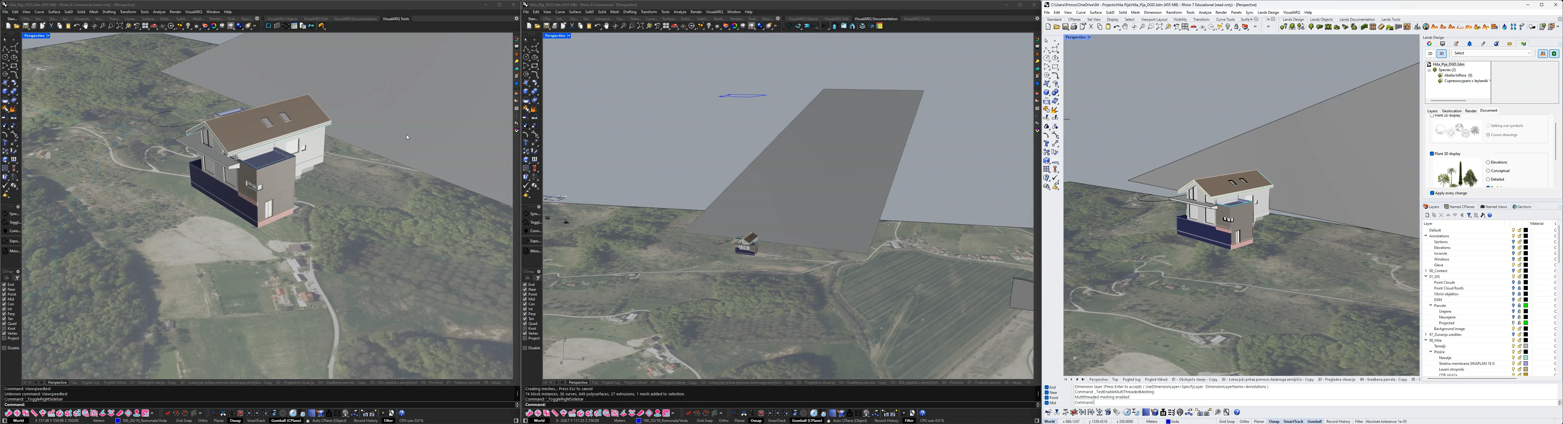

I’ve encountered a notable performance issue in Rhino 8 (SR4 2024-1-9) that significantly impacts navigation speed in perspective shaded display modes, particularly when Tibidabo is enabled. This problem is characterized by a noticeable lag during the initial response to pan, orbit, or zoom actions. Once the navigation starts, it smoothens out, but any new action reintroduces the lag. This behavior contrasts with the fluidity observed in wireframe mode or shaded top view, and interestingly, disabling Tibidabo entirely eliminates the issue.
Observations:
  • The issue presents itself regardless of the file size, though it’s more pronounced with larger geometries.
  • Only the initial movement is affected. Subsequent navigation within the same mouse/keyboard action is smooth.
  • The problem does not occur in Rhino 7 with VA2 or in Rhino 8 + VA3 in wireframe or parallel modes
Troubleshooting Steps:
  • Tested with Tibidabo both enabled and disabled, confirming that the issue is directly related to this plugin.
  • Compared performance across Rhino 7 and Rhino 8, noting that Rhino 7 does not exhibit the same lag under similar conditions.
Below is a video showing performance of the same file in:
Left - Rhino 8 with Tibidabo Enabled
Middle - Rhino 8 with Tibidabo Disabled
Right - Rhino 7 with Tibidabo Enabled
This file is an extreme case, but I have similar issues with other files.

After spending all day trying to figure out why this delay and slowness in selection is occurring, I have discovered that it is due to a bug in Grasshopper for Rhino 8.
To reproduce the problem without VisualARQ, open the 3DM file in Rhino 8, open Grasshopper and open some GH documents (or create new GH documents and insert any components inside). The more GH documents that are not empty, the slower Rhino will go.
The reason you only experience the error when VisualARQ is loaded is because VisualARQ loads Grasshopper automatically. In the 3DM, there are a few VisualARQ Grasshopper styles, and each one contains an embedded Grasshopper document, so when VisualARQ opens this 3DM, some GH documents are automatically loaded.
More in detail, Grasshopper installs a RDK Render Mesh Provider for each open document, and these providers seem to be slow, especially in your document.
Unfortunately, I cannot fix this bug, but I can report it to McNeel, but I need your permission to share your 3DM file with McNeel, as they will need a 3DM file to test.
