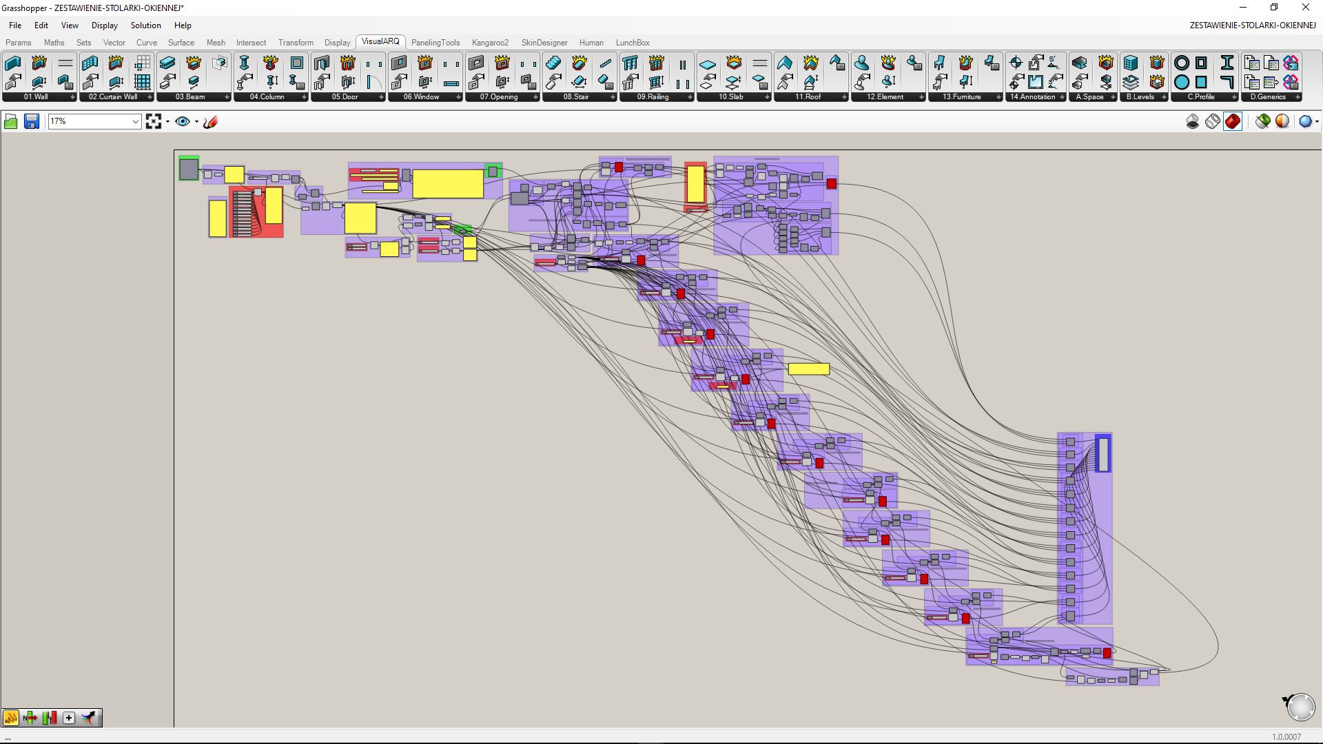

On regular basis I cannot get such a table, so I have written a GH definition, like this:
The first picture is the result of the definition. It takes all doors / windows, reads their parameters, gets elevation drawing, calculates widths and heights of the table, puts info in it and thatās all. I wanted to show you how it works, but I see that with updated VA there is a new error, i think. The table itself is being drawn, except any text:
