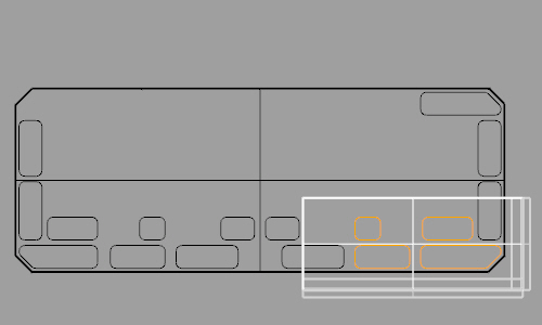

This is working Ok when Rhinoceros Window is not minized, but My applicattion always works minimzed and when it is working minimized, the image is not rendered, it is Wireframe.
This is when Window is not minimized.
This is when Window is minimized
I need to capture the view rendered.
