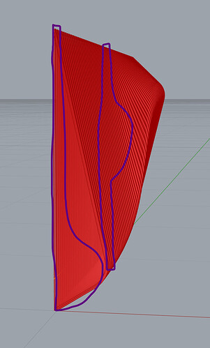

Hello, I need help creating a parametric louvre system allowing me to control the distance the louvres will be on (D) the number of louvres (Nx) and their height (H) and thickness (W) When i say the thickness i mean just the thickness of the Louvre without the extended part from the Attractor curve. I briefly tried but cant get the louvres to stay within the wanted distance and do not know how to make an attractor curve work. Can anyone help and am I explaining it clearly?
This is what i have so far I would just want to make the louvres to be more of that shape like a ball if that makes sense but smoother like the second Image. Ideally i would like to be able to control the extension of the shape as well as the height of the “ball” (top to bottom of the shape that is on the louvres)
this is the script (sorry for chaos)

The topic has already been discussed on the Forum.
I attach my updated interpretation.
