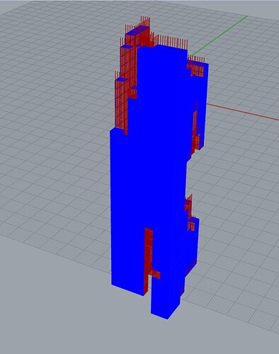

I need to model fixed vertical screens in a rectangular shape, measuring 40x350x60 cm (b x h x p), on the exterior façade of the tower (highlighted in blue in the attached photo). I am also enclosing a photograph of the project used as a reference to give a better idea of the final effect that was intended.
I was thinking of isolating the edges of the squares forming the envelope using “Deconstruct Brep”, then generating an offset of just the vertical edges and continuing by creating a surface and extruding it. I would like to ask if someone please knows how I can select only the vertical edges that I have highlighted in the picture (in the image only one part is highlighted in yellow, I would need to select each vertical edge of the squares forming the outer casing and delete the duplicates, so as not to get errors during offset and extrusion). The Brep in question is the one highlighted in yellow via “Custom Preview”.

Edges from Direction woudl probably also work in this case. Dot product is better as it allows to set a tolerance.

This is a completely different approach. First, all the surfaces are organized into branches by their normal vectors (purple group). Then the vertical edges are isolated (cyan group), duplicate lines are deleted and the remaining edges are all flipped so they start at their bottom end points. Finally, a domain box is created (green group) that replaces the extrusions in the previous effort (version ‘a’).

thank you very much for your valuable reply! I think the second method works perfectly!
