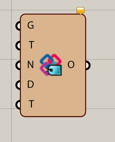

This TAG tile hasn’t changed a bit VA2 to VA3, still no automated baking or grouping, and as I can see, no way to assign individual shaders (unless I am missing something obvious).
Hi @Piotr why don’t use use the Content Cache, or the Custom Preview native components to display and bake objects?
This IfcTag component is used to assign ifc types and other information to geometry. To bake the geometry or display it you need different components in Grasshopper.

In Rhino 7 you can use the Custom Preview to display VisualARQ objects. And there is a Geometry Cache component that should work as well with VisualARQ objects.
But there are no components in Rhino 7 to manage attributes on the geometry (unless you use third-party plugins). That’s new feature in Rhino 8.
