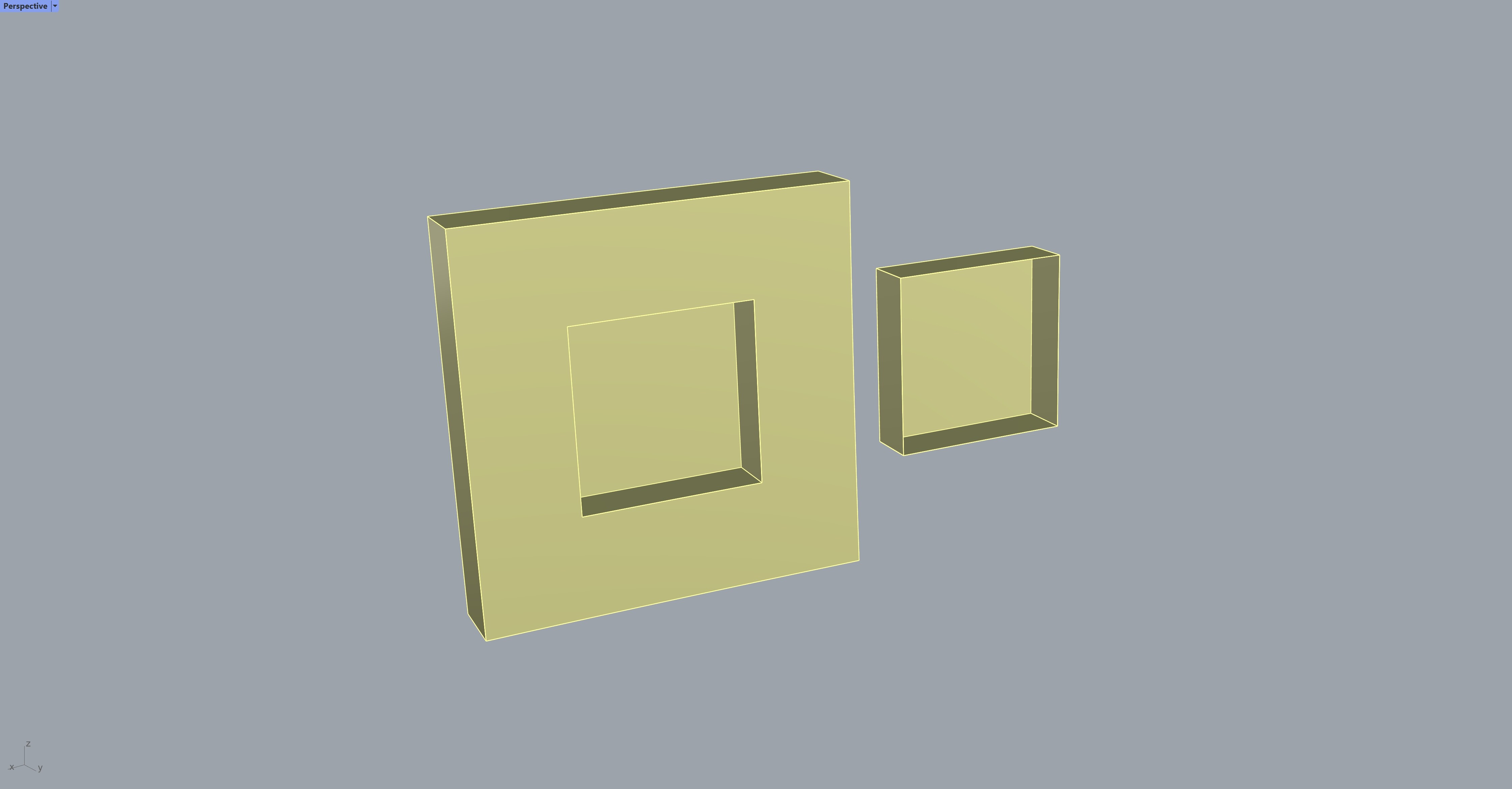

Was working right, but I just had a situation where 2 surfaces were left behind when I tried to extract half of a polysurface.
Hi Joel - please post an example file.
In this part I was trying to extract the entire pocket to copy it to another similar part. In wireframe I drag a box left-to-right that includes all the surfaces of the pocket, but the base of the pocket is not included in the selection. I moved the extracted surfaces to the right in this example for easy illustration.
I tried to replicate it using a simple cube-shaped pocket but then everything selected fine. That made me wonder, if the untrimmed version of the surface that makes up the trimmed base is larger than the window that I dragged, maybe a glitch was keeping it from selecting that trimmed surface. To test that theory I right-to-left dragged in the Extract command, but I get the same result so that’s not the problem.
^ This is a different example than the one I mentioned a few days ago about extracting half of a polysurface.
Can you post a file with just the part in question?
Can’t post anything proprietary.
When I water it down by taking away the rest of the part and then trim to a more simplified shape, the Extract actually works. All pocket surfaces, main adjacent surface, and opposite surface (away from camera) are all the same data as before just trimmed differently. For some reason now it extracts all the pocket surfaces with a single selection window.
If I trim any of the main part away, the Extract works. Even trimming away a tiny sliver on the opposite side of the part. See trim plane below.
Unfortunately the only way to be able to determine what the problem is is to have a repeatable example. Without that, nothing will get fixed, because there’s nothing to test and debug.
I’ll try to replicate it on a part that I can share.
