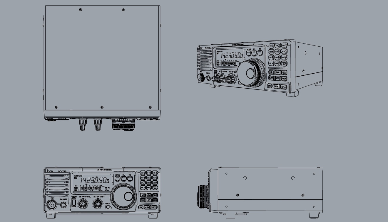

Hi there, evaluating upgrade from V5 to V6, and I’m having issues with V6, especially with Make2D drawing. It appears that many lines on screen aren’t visible, but when printed to PDF they are in fact there. See attached images showing difference in screen output between V5 and V6. Additionally, V6 when in wireframe mode doesn’t draw all edges, and has a tendency to “flicker” when the model is rotated. I’m assuming these issues are related to the specific graphic card I’m using? It’s an AMD Firepro V7900, not exactly a slouch, but now showing it’s age… Have these issues been noticed before on the AMD cards? If the issues are related to the graphics card, what would be a good graphics card that wouldn’

Hi - Could you please run the Rhino SystemInfo command and post the result here? Thanks!
Hi Wim, I had additional issues after installing Vray for Rhino demo that caused my system to hang, I ended up uninstalling V6 (and VRAY for Rhino) as a result. No SystemInfo command in V5…
Aha… appears I only removed VRay and hadn’t uninstalled V6 after all… System info below:

Thanks for that information! The drivers were newer than I had feared.
One of our developers has the exact same card and would like to try to reproduce what you are seeing.
Would you be able to post that file that you are using in this example?

Thanks for that file!
I’m a bit confused about the reported issue now, though. When I open that file, there are no curves on any of the layers. From your description and images, I thought that you had problems with curves.
Do you experience any issues with the file as you posted it in that link?
Please describe in detail what the developer has to do to recreate what you are seeing.

@wim I think you need to run Make2D first.
No issues here on my laptop though, so i presume it’s a driver thing. AMD never got those right…
Hei Jørgen, Yea - but I’m wondering about things like if a specific projection is selected; is there an issue with just the curves in the file and no surfaces; if there are curves and surfaces, do they all need to be visible; etc…
There are just too many combinations and possibilities and without knowing exactly what one needs to look for, time flies very fast and Jeff has other things on his list…

If you run the Make2D command on that (4 views) and save only those curves in a new file - do you see the issue with that new file?
Hi Wim, Yes, exact same issue. I tried printing to pdf, as similarly, all is good in 2D printed output, no missing lines, and no additional surfaces showing up (black shading randomly appearing as I zoom in/out of the model).
