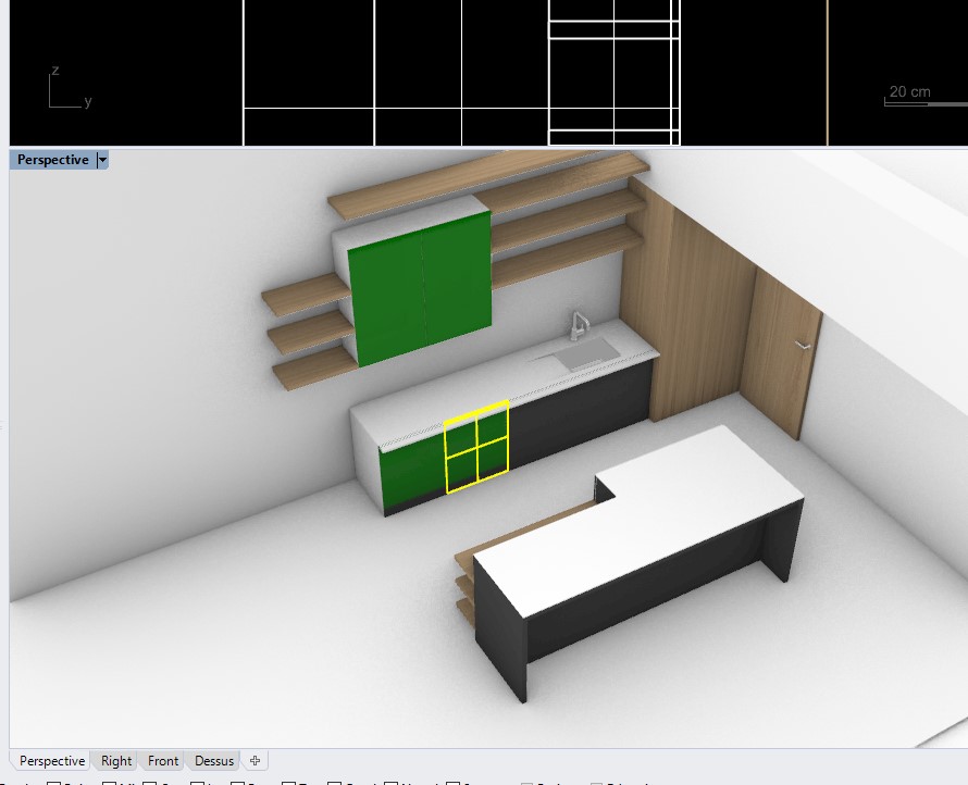

We have had this issue for quite a while - when selecting one object and applying a new material on it, or making the material unique and modifying it, all the objects with the original material change as well.
I cannot change a single pane on a kitchen facade without other kitchen parts turning green.
Is this a bug? I have seen a similar post on the forum, but it was from 2018 - and the problem was fixed back then.
I would really appreciate your help or comments, this is putting me in a difficult situation for my presentation!

Hi Genevieve - it looks like a bug - can you post or send us the file at tech@mcneel.com? Please include a link back to this conversation in your comments.

@genevieve.guex - I need a little more info - how, exactly, are you assigning materials? There are a number of blocks in the file, are you assigning materials inside BlockEdit?

I don’t have blocks in this file.
I have tried to select an object, go to the material palette and select another one, or using the match command and selecting another
object.
The behaviour appears on specific machines but not on my laptop for example.
Hi Genevieve - there are dozens of blocks in the file (see `BlockManager’) - is some of this from a SketchUp file originally? At any rate, when you select an object (one that does not work right) to change the material, what does Properties say about the object type?

Hi Geneviève - Weird… so far I do not get the behavior you show… I’m at a loss. I can apply Leaves to the door you show and that is all that changes - I see there are two objects grouped and there are more groups - are you selecting directly by clicking or using SelGroup, or?

This behavior occurs on two particular machines, but not on our other two. We have tried to ungroup, explode + re-join, copy and paste in a new document. Using the match object properties or creating a new material has the same results - the other objects change as well.
Would you be interested in trying a teamviewer session to se it in action?
