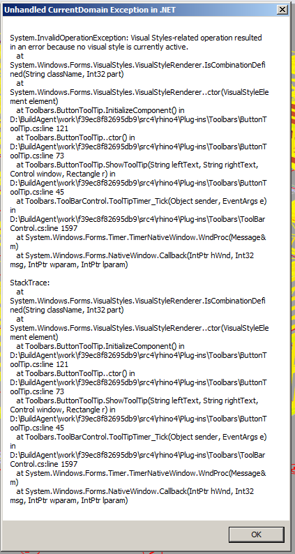

Hi all,
the globall performance is verry amaizing more 300% than rhino 5 (I have us the fraps software to calculate the fps number).
on rhino 5 my modele have 2 fps. On rhino 6 => 6 FPS Good jobs
I use Windows 7 pro x64 with 32 Go ram
Quadro K2200 2Go Go ram
xeon 3.5Ghz
Rhino 6 post to errors message
this error message appears at the moment of opening file
this error message appears a moment after opening files
regards

Also I tried to open my current complex project models. Rhino 6 fails to open the files.
So, from my side, no improvement, not usable.
