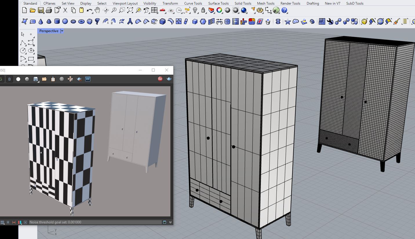

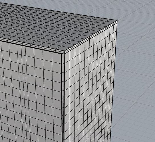

when i try to reduce only 3 meshs of my incomplete object look what i have
Hi Emile -
From your requirements, it sounds like you should model the objects with meshes - not converting a NURBS object into a mesh. You can use the NURBS object as a guide to snap to but you’d be using the 3DFace command with PolygonType set to Quad and Append to build the object.
Hey, i draw the model in subd using crease edge everywhere.
the reason why i use it is to can edit UV.
I have this :
1st plan : the model in subd, 2nd plan : the quad mesh model, which one i have to use ?
other question : how to get an unified mapping between all parts ? (Scale, direction, symetrie)
Hello- ApplyBoxMapping to all the parts at once.
