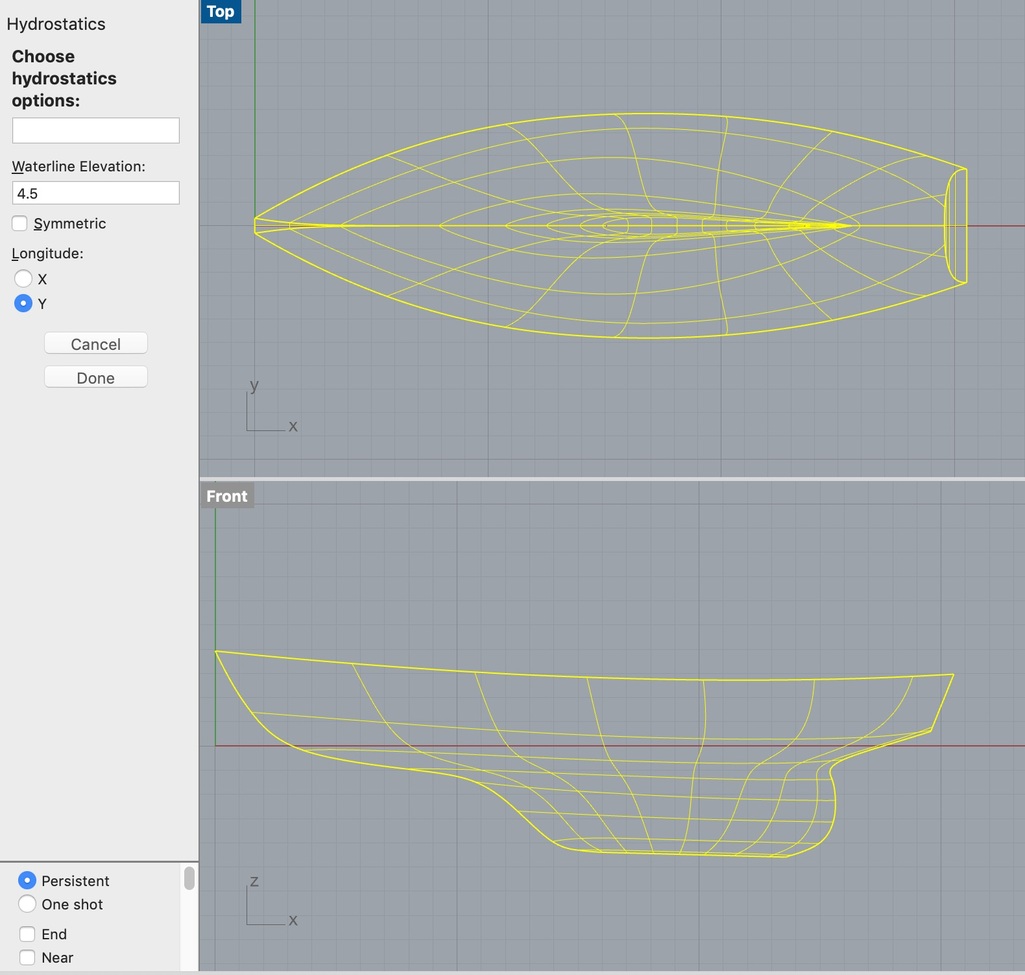

I am trying to compute some properties of a sailboat hull using the hydrostatics mass analysis tool. The model is well-formed. I am running into a problem in that all I get is wetted surface with water plane = 0. None of the other measures (center of buoyancy, etc.) that hydro is supposed to compute are computed. I am somewhat new to rhino, so may be doing something stupid. Has anyone had experience working with the hydro analysis tool in Rhino?

One question: when I invoke hydro there is a dialogue box asking me to select hydro options (this is different from specifying the waterline height, the long. axis and symmetry). I’ve left that blank-- not knowing what to put in to get the full computation. Should I be putting something in there?
here is the dialogue asking for options
Ah — 4.5 for the waterline is above the model… your units are feet.
well, this is interesting. Before the join, the world origin (z=0) was at the base of the keel, and the waterline was at 4.5. Now after the doing the waterline is at z=0.
When I set that I get REASONABLE results being computed. Thank you so much for your help!
