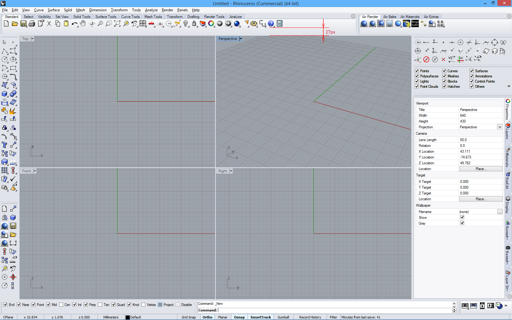

I am using Rhino 5 (64-bit) SR5 (5.5.30627.15215, 27. 6. 2013) release running on Windows 8, 64-bit.
I have a problem to get back the original height of the upper toolbar. When I drag the bottom edge of the toolbar row up by mouse, trying to get back the height, it stops in some height (27px) bellow the inside icons and don’t want go up to be thinner as it was first time. Is it bug or wrong setting? How to fix it? It takes lots of unused space.

See attached picture:

I have not seen this before- does it behave any better if you undock the toolbar that is on the right? @JohnM do you have an idea?
No it does not help. It behaves same way if there is or is not the toolbar on the right side.

It appears to have something to do with the fact that you only have one row of tool bars docked at the top. If I dock something above them it works fine. I am checking into this now and will try to have a fix in the next service release.
-JohnM
I was able to get this fixed and included in the next SR5 release candidate build.
