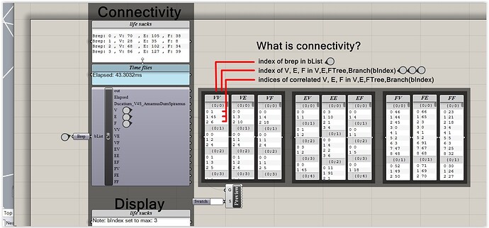

That said: these things that you are after are done solely using connectivity. A Brep (and a Mesh as well) has 3 classes of geo: Vertices, Edges and Faces meaning that the possible conn Trees are 9. If we are talking about Brep Lists (real-life) these Trees are 2 dimensional
…where path.Indices[0] is the index of the Brep in the Brep List and path.Indices[1] is the index of the master item in the related branch (path.Indices[0]) of the items Tree (in V, E, F one dimensionTrees).
So as a challenge get a List and try to do this kind of stuff :
Or this for a Mesh List:
