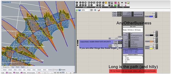

Thank you! It is an interesting approach to the problem.
Added a few lines more providing an indicative result on the mesh faces related with hits.
Morph_Flow_EntryLevel_V1B.gh (162.1 KB)
NOTE: Mesh is auto triangulated. If you have quads and you want to work with them then you must sort the face indices/vertices (for obvious reasons). One way to do that is the classic MTV.SortEdges(MTVIndex) (plus some basic Lists ops taking into account MTV connectivity). The other (way simpler) is to sort by angle with regard the XAxis of a facePlane (faceCenter, faceNormal).
