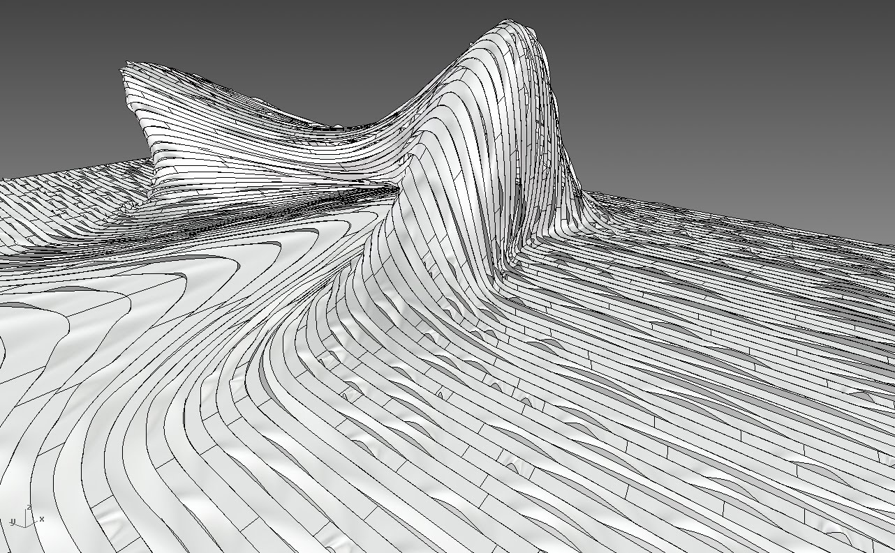

Hello guys!
Is there anyone who has this subdivision script cause i cant find the page on the site.
 ![16](https://global.discourse-cdn.com/mcneel/original/3X/2/9/2939d2c09af4b81e4666532b16fda1a67d74ab3d.jpg)
 ![03a](https://global.discourse-cdn.com/mcneel/uploads/default/original/3X/b/0/b0092a8dcddfceff35ba57548d64a2aeec9c3915.jpg)
> **[Uneven Subdivision 01\_Co-de-iT/////////////////////////](http://madeincalifornia.blogspot.com/2010/12/uneven-subdivision-01co-de-it.html)**
> computational design blog with grasshopper, rhinoscript and other forms of codes as resarch systems.
Thank you!!

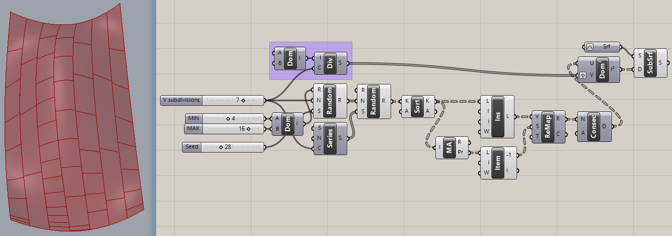

![Uneven_Subdivision_2018Mar30a](https://global.discourse-cdn.com/mcneel/original/3X/d/1/d1094456e2c1f56b663b775a39fbc34224c4768a.png)
[Uneven\_Subdivision\_2018Mar30a.gh](https://global.discourse-cdn.com/mcneel/uploads/default/original/3X/7/3/73b72825cb3ffac028a85db05837b70acc4ac2f8.gh) (20.4 KB)

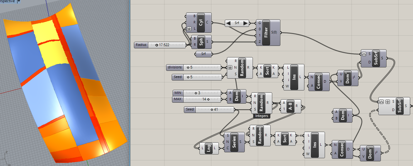

Getting uneven divisions in both directions is more complicated!
 ![Uneven_Subdivision_2018Mar30a2](https://global.discourse-cdn.com/mcneel/original/3X/4/c/4c1a8953b8a06f0d64206c1d22944a495bb83cb6.png)

> [@cokerone1214](#):
> …this one ( which is on the site ) create random rectangle subdivisions only in one axis. Either U or V. The one i am searching for creates a totally random subdivisions and i don’t have the knowledge to adjust anything to the first script in order to do what i want.
 ![Uneven_Subdivision_2018Mar30b](https://global.discourse-cdn.com/mcneel/original/3X/1/f/1f3b00d0655e82068ff9117ccffa073cf56fd714.png)
[Uneven\_Subdivision\_2018Mar30b.gh](https://global.discourse-cdn.com/mcneel/uploads/default/original/3X/4/7/47ba2ddaa71dce123bb919ccc807cf6d7f2f1a2a.gh) (30.0 KB)
_P.S. re-posted wiih two_ Seed _sliders._

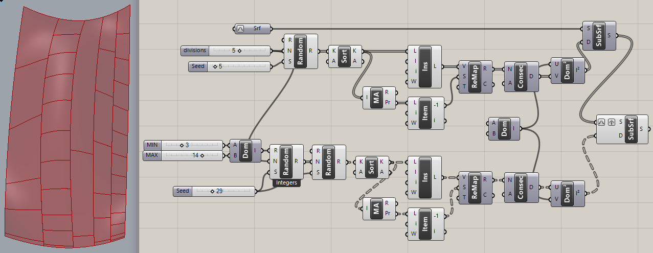

When I connected a gradient color preview and explored different ‘Seed’ settings, I noticed a sorted pattern, not random… due to a ReMap error.
 ![Uneven_Subdivision_2018Mar30c2](https://global.discourse-cdn.com/mcneel/original/3X/2/3/2302026122ddce673cd611c9cfccbb2fb606ddc7.png)
So made a small change to fix it(?), and an off-by-one error.
 ![Uneven_Subdivision_2018Mar30c](https://global.discourse-cdn.com/mcneel/original/3X/e/3/e3a03afa6db74b09154819d9f298c64dbd45f2e6.png)
[Uneven\_Subdivision\_2018Mar30c.gh](https://global.discourse-cdn.com/mcneel/uploads/default/original/3X/b/8/b8ebd4e6885d7f5396d29d908497cb760aaaa40e.gh) (29.6 KB)

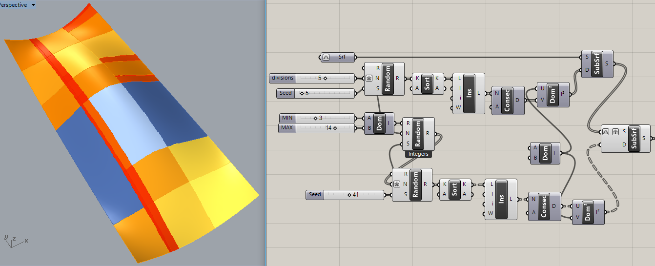

Later… I dropped something in versions ‘b’ and ‘c’ that I shouldn’t have., A Series of seed values so each subdivision has a unique sequence of random numbers. Remembered to internalize my surfaces this time!
 ![Uneven_Subdivision_2018Mar30d](https://global.discourse-cdn.com/mcneel/original/3X/6/5/656810414b1e954dc0a8ef5f7186567f2c13f962.png)
[Uneven\_Subdivision\_2018Mar30d.gh](https://global.discourse-cdn.com/mcneel/uploads/default/original/3X/8/2/824053adc30286cc3a25029b9ffa1ea56adfcda6.gh) (32.5 KB)
 ![Uneven_Subdivision_2018Mar30d3](https://global.discourse-cdn.com/mcneel/original/3X/9/8/98c3717392ffb7af25664b87a13f7cb7921f871f.png)
 ![Uneven_Subdivision_2018Mar30d2](https://global.discourse-cdn.com/mcneel/original/3X/2/f/2f5d4e450ca3658d6b9ee07a1336d785779c56e7.png)

The issue of a unique seed for each subdivision vs. using the same seed for all is so interesting that I added a switch between the two states _(cyan group)_. When the same seed is re-used, edges are aligned across subdivisions, which takes some thinking to explain… It happens because the numbers are generated in random sequence and sorted, leaving gaps in shorter lists but using the same values.
 ![Uneven_Subdivision_2018Mar31a](https://global.discourse-cdn.com/mcneel/original/3X/d/5/d5099a7cb1d4c8fc8fd8eee8a310584e86a26cd0.png)
 ![Uneven_Subdivision_2018Mar31a2](https://global.discourse-cdn.com/mcneel/original/3X/8/7/87e82df6e08aa9f9a528e5479780f61a35f14084.png)
[Uneven\_Subdivision\_2018Mar31a.gh](https://global.discourse-cdn.com/mcneel/uploads/default/original/3X/8/1/81246545b748e205b99b1b50a0797b2e3118a1c6.gh) (37.7 KB)
The other error I made, effectively sorting the subdivisions by size, is also interesting and a valid objective. Subtle changes, critical differences!
