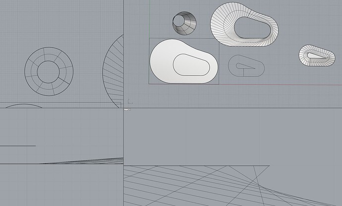

I don’t want to clutter the forum but I’m new to Rino and I’m looking for solutions. so please be understanding. How can I connect the two planes, top and bottom, so that I can then create a bevel on the plane - a simple straight bevel between them? Using the “Loft” command, it connects me but “diagonally”. For example, I made a different geometry - circles in the upper left corner. I need to connect two planes on the lower model (bottom left corner) as in the example in the upper left corner. Somehow so that the lines are perpendicular between the edges of the planes. what command could I do this?I can’t explain it better, but I think you can understand it by looking at the drawing.

Hi Tom - in this case,
I’d make multiple surfaces and join them - the top and bottom curves are not really going to work too well together.
Pascal, this is exactly what I needed !!! Can you tell me how you did it, what commands, or can you record the screen as you do it?

Please review the help on these commands
https://docs.mcneel.com/rhino/8/help/en-us/index.htm#commands/sweep1.htm?Highlight=sweep1
