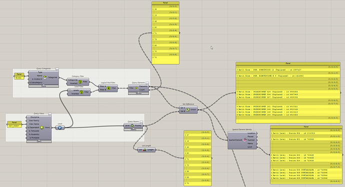

Two methods of Query Rooms, different results
I wonder if these two methods of querying rooms shouldn’t return the same results.
If I purposefully remove the “Placed” input from the Query Rooms component, shouldn’t the component output all Rooms? Logically if I remove some criteria, that criteria shouldn’t be taken into consideration. Right now the top group method using adding filters outputs all the rooms and the bottom one outputs only placed ones.
Using RiR 1.18.8662
HI Jakub,
Can you post or send the file? Ideally an isolated example, but if you need to send a large file you can upload privately here… Rhino - Upload to Support
I tried to extract a small portion of the file and still have this issue present but I couldn’t do it.
If I will try again with success I will let you know.
