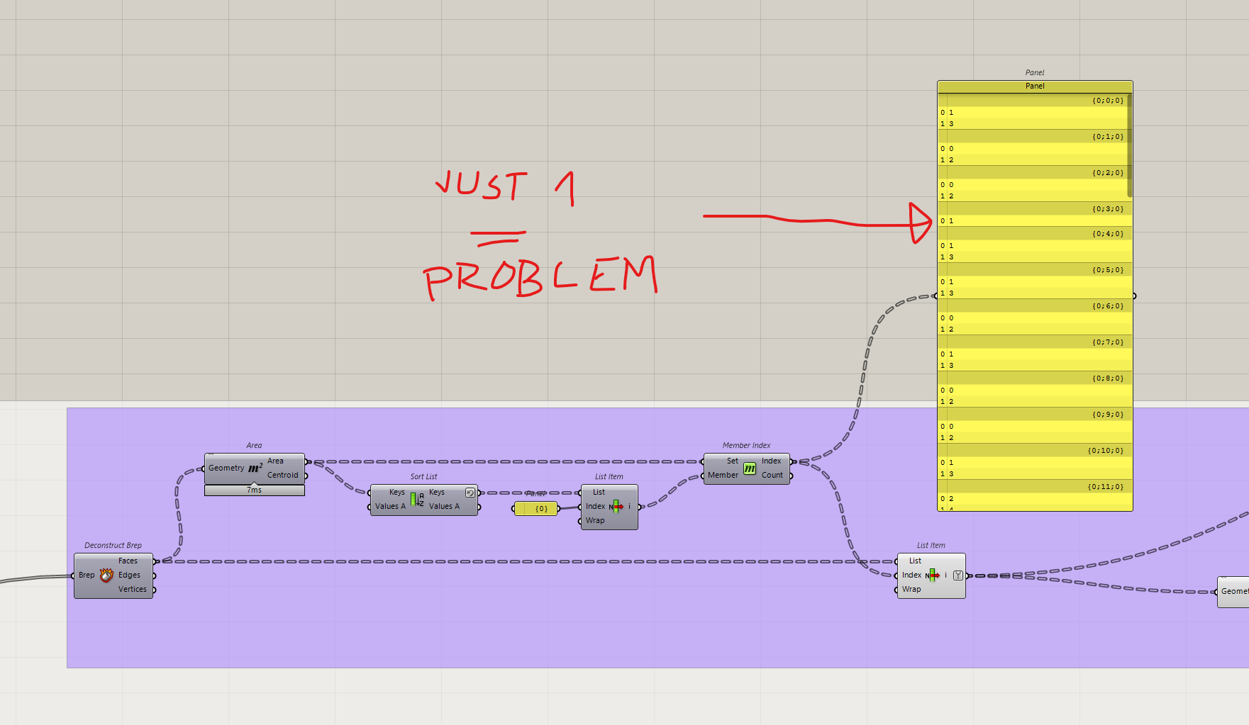

Hi, so im taking some Breps, deconstructing them and sorting the faces by the highest area. In 95% of cases it works as intended, but sometimes it only takes one biggest face. That is annoying cause I cant make a line through the centroid of those 2 biggest faces. My question is how to make it work all the time? Thank you in advance!

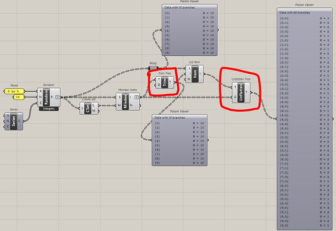

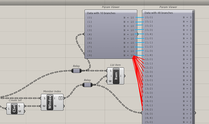

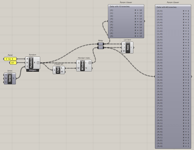

after looking at your screenshot, you are in a classic data tree problem, where pairing is based on branches, and repeat last:
so this is more or less how you are making list item work in that case:
you can probably solve it with Trim Tree + Unflatten like this:

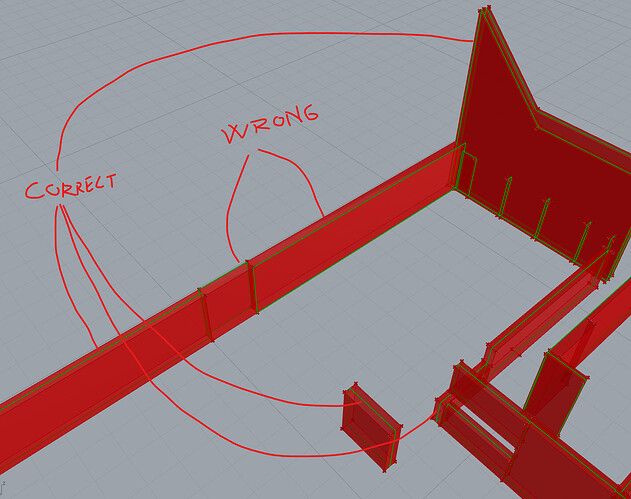

So again to sum it up, wherever i get the middle curve between the 2 biggest faces of Brep - this is correct, but sometimes it creates the curve on top of one of the sides od the 2 biggest faces of brep. Thank you in advance :slight_smile:
Different area value.
It is best to format to 2 or 3 decimal places.
Uff, what an obvious mistake haha… I rounded it to 3 decimals with a function and now everything works as intended. Thanks a lot!
