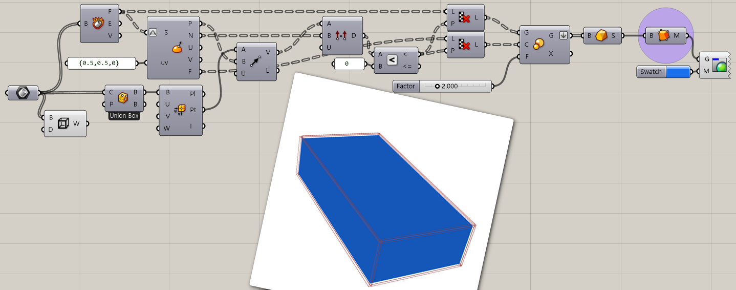

I am new to grasshopper, and have come to the software with a specific problem I am wanting to solve.
I have six volume meshes that make up the faces of a cuboid.
The constructed cube is not necessarily watertight.
I want to extract a solid mesh that represents the void enclosed by the six volumes.
I have tried a few methods so far without success, such as spiting the volumes into surfaces, and using the internal surfaces to define a new mesh, however, I have not been able to identify “internal” surfaces.
I would be grateful for any suggestions.

Have a look here. Theres gotta be an easier way to get a box around four points in space though?
voidbox.gh (22.2 KB)
This is a way using Boundary Volume.
Space Extract_re.gh (22.9 KB)
Got a little closer with the points-based approach, still not quite what @HS_Kim got.
His surface-based approach is more accurate (ie: actually solving the problem)!
voidbox.gh (24.4 KB)
Thanks Amir! this is exactly what I was after. would it be possible to talk me through the thinking behind thi please as I am new to Grasshopper.
I got all of your breps corner points & grouped them, getting 8 “corner groups”. Their average is our temporary “center point”. Grabbing the closest point of each corner group to our center point gives us the 8 points describing the final box.
HS_Kims box is more accurate in a way since it generates the shape using the bordering surfaces. I guess that’s what you were after. Zoom in and compare them to see the differences.
Thanks HS_Kim, this appears to be doing exactly what I want, and according to Amir, it is superior to his solution. Would it be possible to explain how it works please?

In this case, it works but can’t guarantee that it’s a general solution for this sort.
Space Extract_reV2.gh (47.4 KB)
