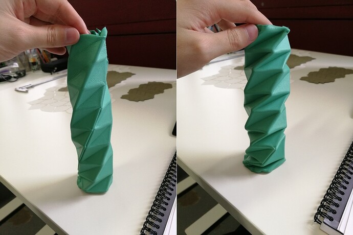

I need to build a polysurface recreating a sleeve folding in the origami style like in this picture
When it contracts, it folds itself towards the inside, and the top part rotates counterclockwise.

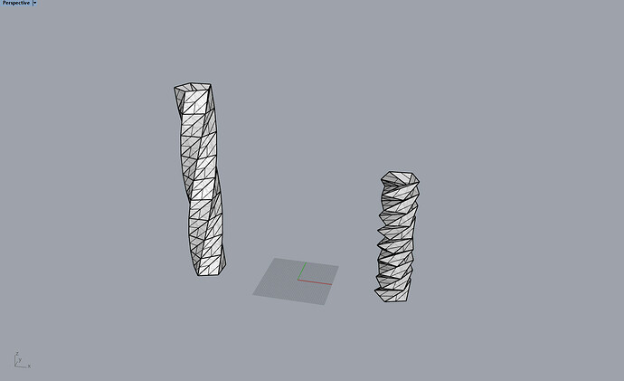

As of now I can build it in its deployed and retracted forms, but my boss wants a model he could see unfold on screen.
So I have 2 problems :

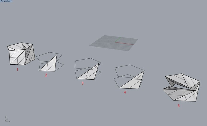

1st, what can I do too keep the triangular surfaces of the deployed form in the retracted form ?
Until now, I first built a segment of the deployed form (1), then lowered the top building curve to the dimension of the retracted form (2), in this case from 120mm to 75.55mm.
Them I rotated the triangular surface along the pentagon side so it’s tip would be aligned to the top pentagon, then rotated that top pentagon to align an angle to the tip of the triangular surface (3).
I then delete that surface and build a new 3 points surface with a side of the lower pentagon and the angle of the top one I’ve aligned in the step before (5)
To finish, I duplicate my new triangular surface to build a segment of the retracted form.
This was good enough when all I had to do was to estimate if I had enough room to put an elevation column inside my sleeve, but now that I need to build an evolving surface this will not do anymore.
2nd, and it’s tied to the first question, is how do I build a folding surface ?
What I had in mind was to build the deployed form then fold it to the retracted form, but I don’t know how to do that.

This specific pattern is an interesting one because it cannot actually fold rigidly. It only works in the real world because the facets bend and stretch slightly.
So don’t feel bad about not getting the lengths consistent when modelling it geometrically in Rhino because it is impossible! The real behaviour of these triangulated cylinders is rather complex - this one even has an interesting pop-through behaviour where it snaps between different less stretched states
https://www.pnas.org/content/115/9/2032
I’ll put together a grasshopper file to show how this can be modelled.
