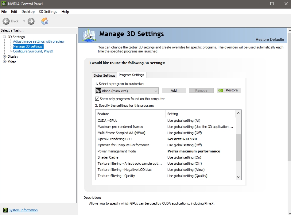

For the record, the problem was that my computer has both an NVIDIA GPU and a less powerful graphics card, and Rhino was using the wrong one. The solution was changing the NVIDIA GPU’s settings. I didn’t come up with this on my own, it was suggested by Holo in response to a separate thread about a separate problem.
@mbabcock Can you link to the other post with relevant nvidia settings?

Hi Mikolaj - that would be this one:
Thanks Wim, but these are my current setting (using RTX 2070) and still I’m getting this behavior (in case my description was not clear):
