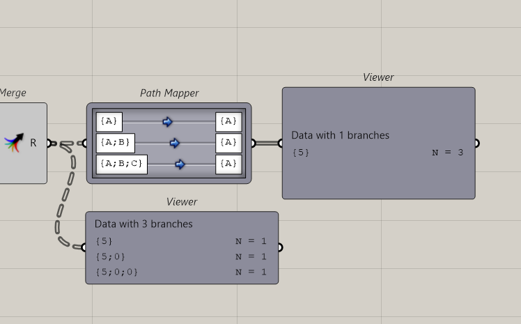

On many occasions data can change structure between branch depth=1 {0} and branch depth>1 {0;0}

Also, with the Path Mapper, you can control what happens on each case

you might already be aware that whatever numbers are written as path of any data tree branch, gh doesn’t really care about those, it will just pair branches 1:1
you can use Principal modifier (Right click on input) to tell the component you want the output paths to be based on the paths of a particular input
