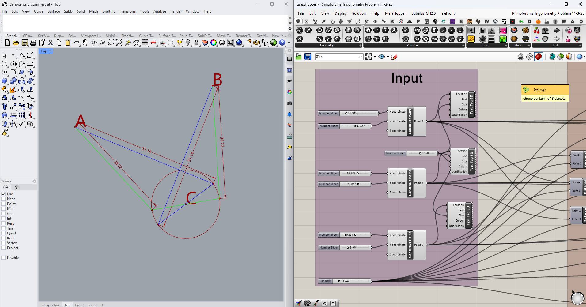

Hi, I am struggling with a trigonometry challenge and I hope some brains can help out.
3 points given. A, B and C. Point C is fixed, but A and B are movable. I am looking for a definition that returns two lines of equal lenth (a,b) whereby the blue line must have C as midpoint.
The system is like a scale with two equal springs finding their equilibrium.
I would like to solve this mathematically rather than with kangaroo.
Thanks a lot!
0311Equilirbium.gh (12.7 KB)
These are the 90° triangles and thales circles
Thanks for that break-down into 90° triangles, I think this is a great approach

Hello Ulrich Merz, a fun challenge to try to solve. Thank you.
As far as I can see there are always two solutions. One with crossed lines and one not crossed. But my knowledge of mathematics is far too limited to be able to prove this.
It is clear that in both solutions there is no movement in the system, due to the fixed location of point C and the fixed radius of C.
Here follows a Grashopper Definition that shows this challenge dynamically:
Rhinoforums Trigonometry Problem 11-3-25.gh (52.6 KB)
Hello Ed, this is awesome! How did you come up with these expressions. Chapeau
Thank you. I made them with “Geometry Expressions” (very old and sometimes clumsy software with bugs, but also unique. Takes a while to work with the flaws.) and Maple.
Maple gave 8 solutions, but as you can see in the program, it actually turns out to be only 4 solutions. I could have taken that out.
Nevertheless, there are areas where the solutions give a NaN. I am still looking into whether there is a way around that, I am working on it now, it will take a while before I know whether that is possible or not. I also do not know whether there are no solutions, or whether the expressions give a NaN (because of Sqrt(-x)).
If I do have a solution for NaN, I will post a new definition. I have already read up quite a bit on NaN here on the forum, so with that information I will see how far I get.
----Now without NaN, but it doesn’t matter for the solution. So there are probably areas where there is no solution, or my method is not complete. Here is Grasshopper definition without NaN (You need IAC plugin for the polynomial solver):
Rhinoforums Trigonometry Problem Wihout NaN 11-3-25.gh (53.3 KB)
