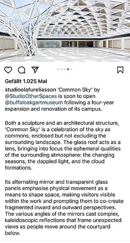

how do I get the Triangle Pattern on the glass? these are supposed to be gray. Is there a script for this? It should not be full, but in some places a little erased
Pattern on glass.3dm (11.7 MB)
this is how it should look. This is the inspiration
I would be really happy if someone could help me
