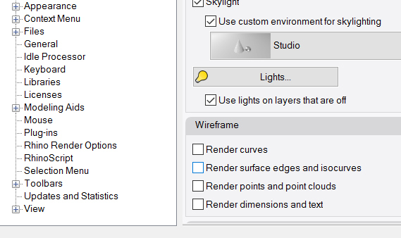

Hi Nick,
I thought we could put the surface on a layer turn the layer off, but turn on “Use lights from layers that are off” under render settings but this doesn’t seem to be working in V6.
Maybe another setting I am overlooking.
RM
