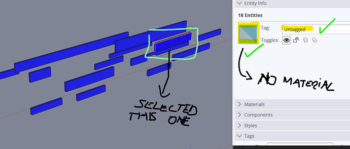

Sure thing! Here the files @mary.
  • I have 16 rotated prisms in Rhino. (polysurface)
  • In layer ‘Rotated Boxes’
  • With Red color
  • With Material by Layer set to ‘BLUE MATERIAL’
Now I Sketchup, best practice should get me:
  • 16 ‘sketchup groups’, one per each polysurface.
  • Each group in tag ‘Rotated Boxes’
  • Inside each group, the edges and faces (you can think of them as sub objects) should be in Untagged layer.
  • Groups should have material named ‘BLUE MATERIAL’ assigned and display as blue because Sketchup displays material color.
  • Faces and Edges (the objects inside the groups) should have no material assigned.
See here: When I enter a sketchup group and select the faces and edges inside (6 faces + 12 edges = 18 entities) The layer is Untagged and It has no material assigned. This is the correct way.
Here the models:
Test Model_3DM.3dm (454.0 KB)
Test Model_SKP .skp (92.7 KB)
