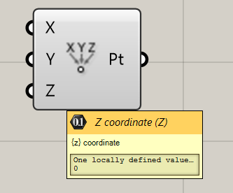

Is there any way to have the Python component show a “locally defined value” like the native components do?
Right now I define default values in the script by checking the inputs for None (nothing connected) and assigning a default value if this is the case, but the only way I know currently to indicate that default value to the user is in the docstring…
